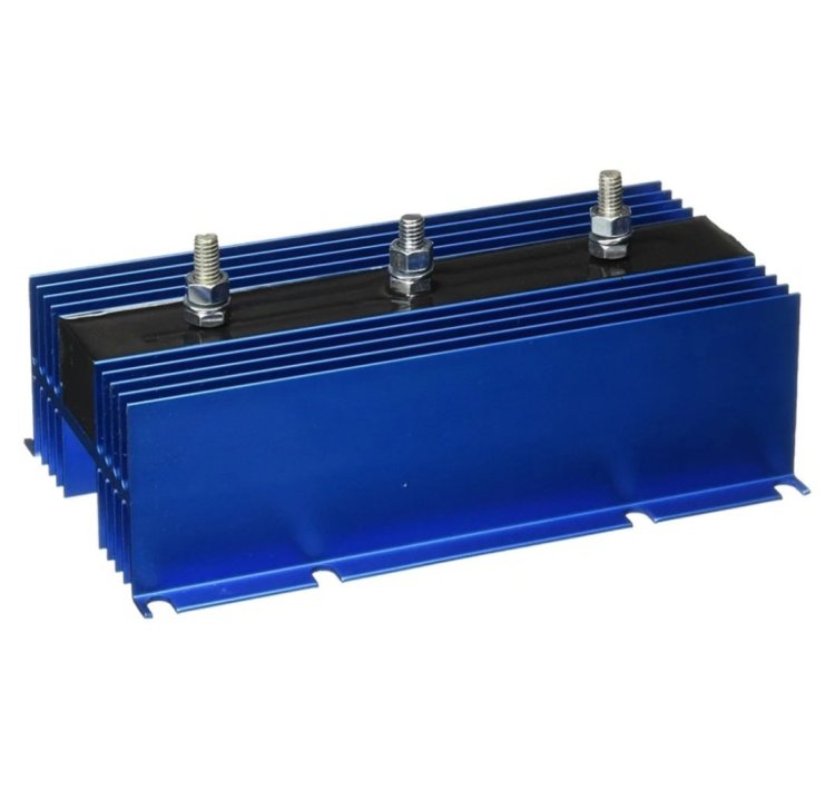

That's similar to how I wired my 2nd battery for powering the winch. Not sure if it's still used, but I used a battery isolator like this:
I could draw down the winch battery, but not affect the starting battery.

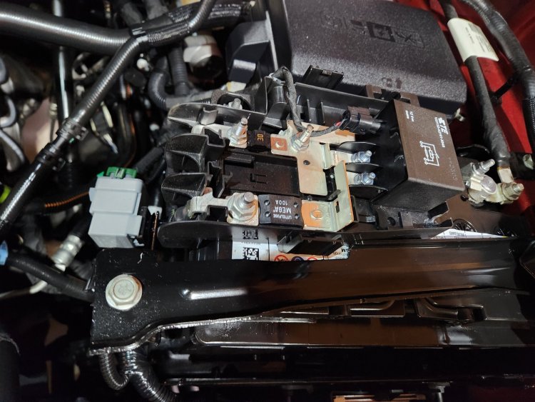

Do you think that the wiring/electronics would allow power to flow from the aux' battery during cold temp' starts?
The truck includes the True North Pkg, but the 220 A alternator & aux' battery are not part of it.
