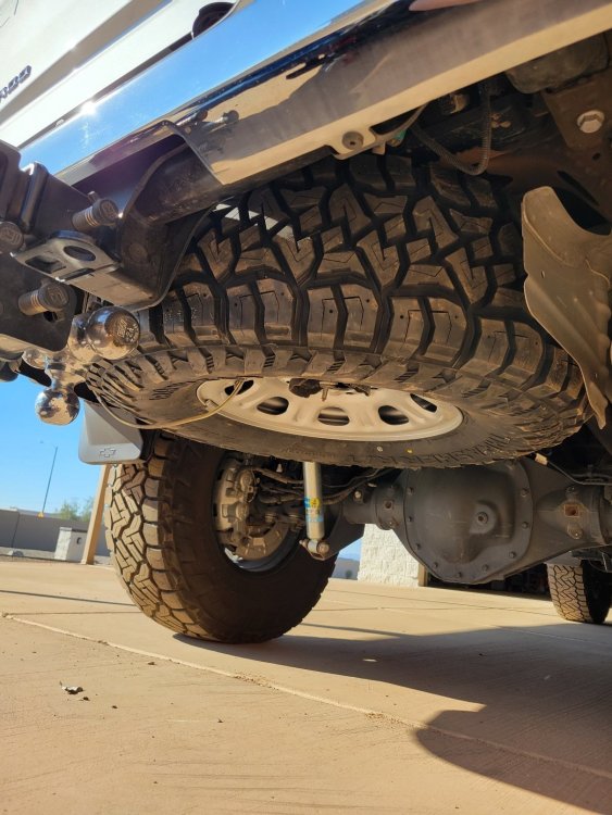

A 37x12.50R18 will fit there (roughly 315/80R17 in metric with 17" rim)
Edited by Epsilon Plus
You want an air gap or insulation between the tire and the exhaust heat shield. The shield absorbs the radiated heat from the exhaust pipe, and is cooled by the moving air, keeping the tire from directly receiving the radiated heat. If the shield is in contact with the tire, the tire surface will receive a lot more heat and reach a higher temperature. I don’t know how high, but I assume GM put the heat shield there for a reason.
I have a gas truck. That tire could lay up directly against the pipe in that spot and be just fine as could your hand. It's probably for DPF laden diesels.
I have a stock 275/70-18 (33.1") spare with 295/70-18 (34.2") driving tires.  I went through the same thought process and decided to leave the smaller stock tire as a spare.  It is a 1.1" difference, which is a lot less than your difference.  My reasoning was that in 40 years of driving a pickup truck on and off road, I have never had a flat tire.  One reason that I am a fan of the BFG All Terrain T/A tires.  My last truck was 17 years old before it was stolen, and the original spare had never been dropped down.
If necessary, my plan is to put the spare on the front to avoid a problem with the rear differential.  Reading stories from people who have temporarily driven with a smaller tire on the non-drive axle, it is not a significant problem.
I also wondered about the larger spare fitting, but from that other reply, it looks like it will.

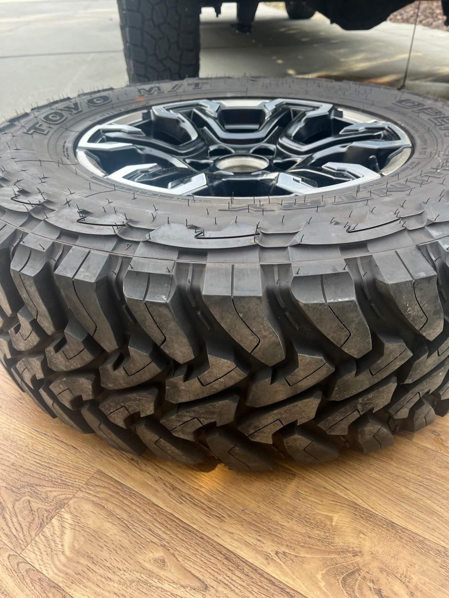

I got rid of my 20" and went with the factory ZR2 18" wheels and got an extra one and mounted the same size tire on it for a spare.  I went with 285/70-18 Toyo Open Country ATIII's and found a practically new Toyo M/T tire on FB market place for $25 and used it as my spare.

The larger spare does fit quite well back there. I think these tires are about 34" outside diameter.
