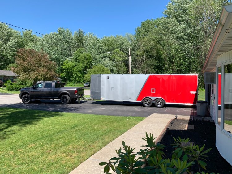

picture for size reference
And the smaller trailer. But loaded down with 3 guys in the truck, 4 motorcycles, and every other square inch full of gear and supplies for a trip 900 miles one way

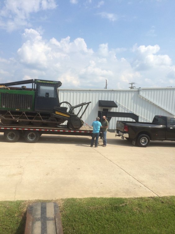

Blast from the past. Pretty close to what I pulled with. No way a truck is going to stop that without good trailer brakes.
