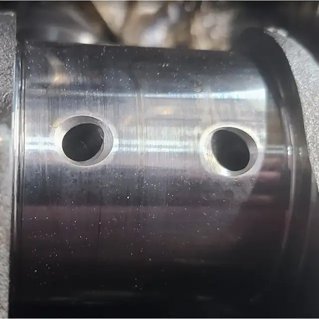

The oil had nothing to do with this newer bearing issue, using Mexican slave labor is the reason and is why GM made up the oil excuse to cover for them trying to cut cost here. Here is a picture of a never used 6.2 crank shaft journal. Thicker oil is not going to help this....
https://www.youtube.com/post/UgkxOoK_u2eUoqt7OR57ycVxpJ5svANfOCQa
I agree. I live in Texas and thousands of trucks losded on rail cars pass through here everyday coming from Mexico.
I looked at many CPO (certified pre-owned) trucks and almost 80% were built or assembled in Mexico.  I finally located a truck that I wanted. It had 60k miles. It is a '20 Denali, so outside of the recall.  It has the 6.2L DFM and Auotstop and a 10spd. I tuned out both, first with a Pulsar LT,  then with a DiabloSport trinity and a LEW custom tune. I have had no problems at all, from motor or trans. ..But. this truck was built  and assembled completely in the USA. at the Roanoke plant.
It makes a difference.  Quality, built with American hands. Engine and transmission, assembled in the United States of America.
