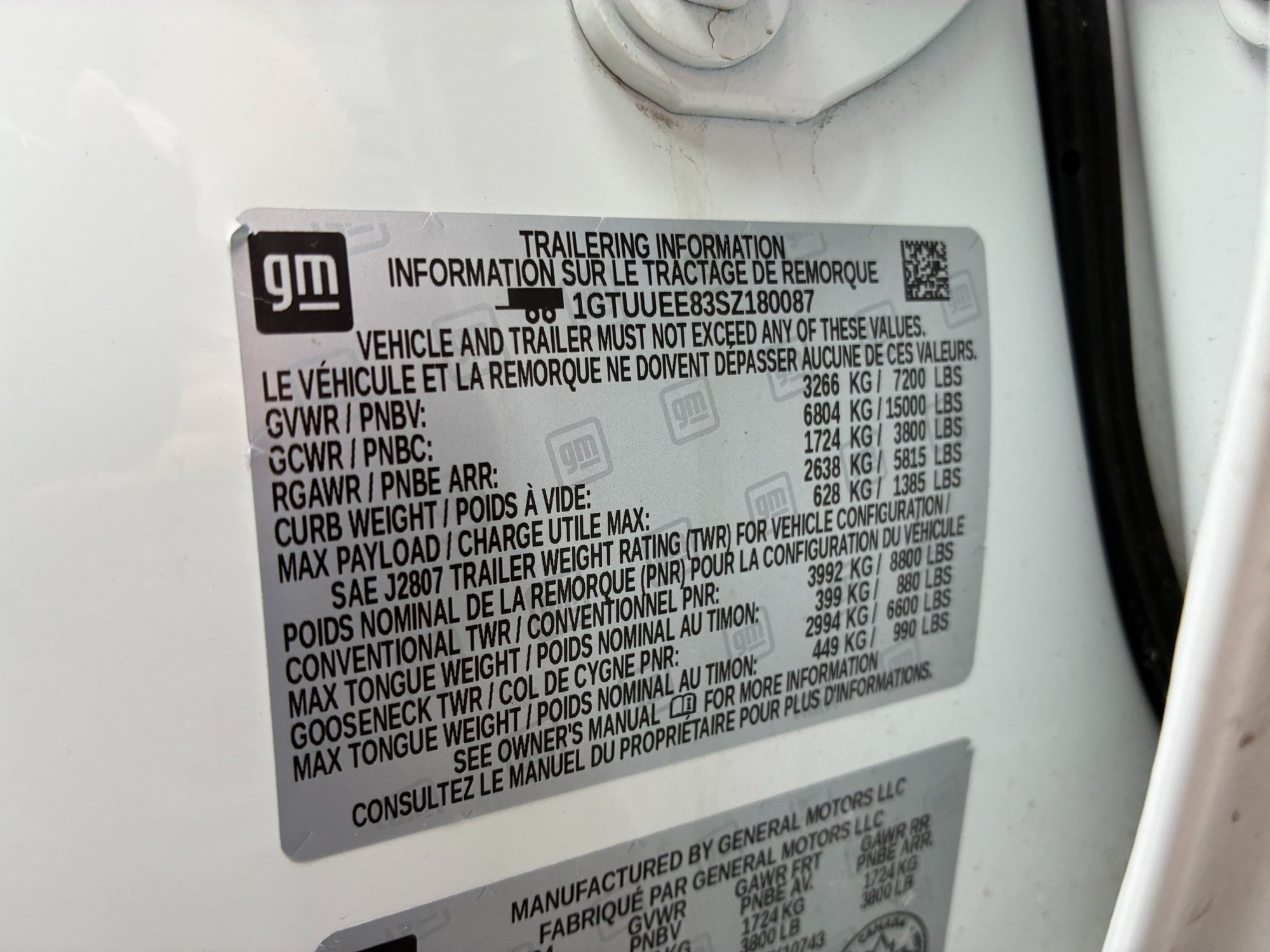

Have you actually looked at the trailer door sticker on an Elevation diesel to see the "as built" payload its rated for?  Not just the online website numbers.  The numbers on the GMC site or the GM Order Guide don't actually tell the full, as equipped and optioned, on the ground built truck payload.  If you were over on a Tundra, a 3.0 Duramax 1500 won't be much better if better at all.
The best payload on a 1500 GMC would be a 2.7 Turbomax in Pro configuration, but you can step to SLE or Elevation and still probably be in the 1800-1900lbs payload range.
IMO, a cheapo commuter car sounds like the best move perhaps?
Here's an SLE crew 6ft.6in:  1521lbs payload, 8700lbs towing, 870lbs max tongue.  GM calculates at 10% trailer weight for the tongue rating.
Here's an AT4 crew:  1385lbs payload, 8800lbs towing, 880lbs max tongue.  GM calculates at 10% trailer weight for the tongue rating.

Yes, the specific Elevation I checked has a payload of 1,631, which I was pleasantly surprised with. My 2010 Tundra's payload was about 1,300, so the Elevation would definitely have given us some more capacity.
