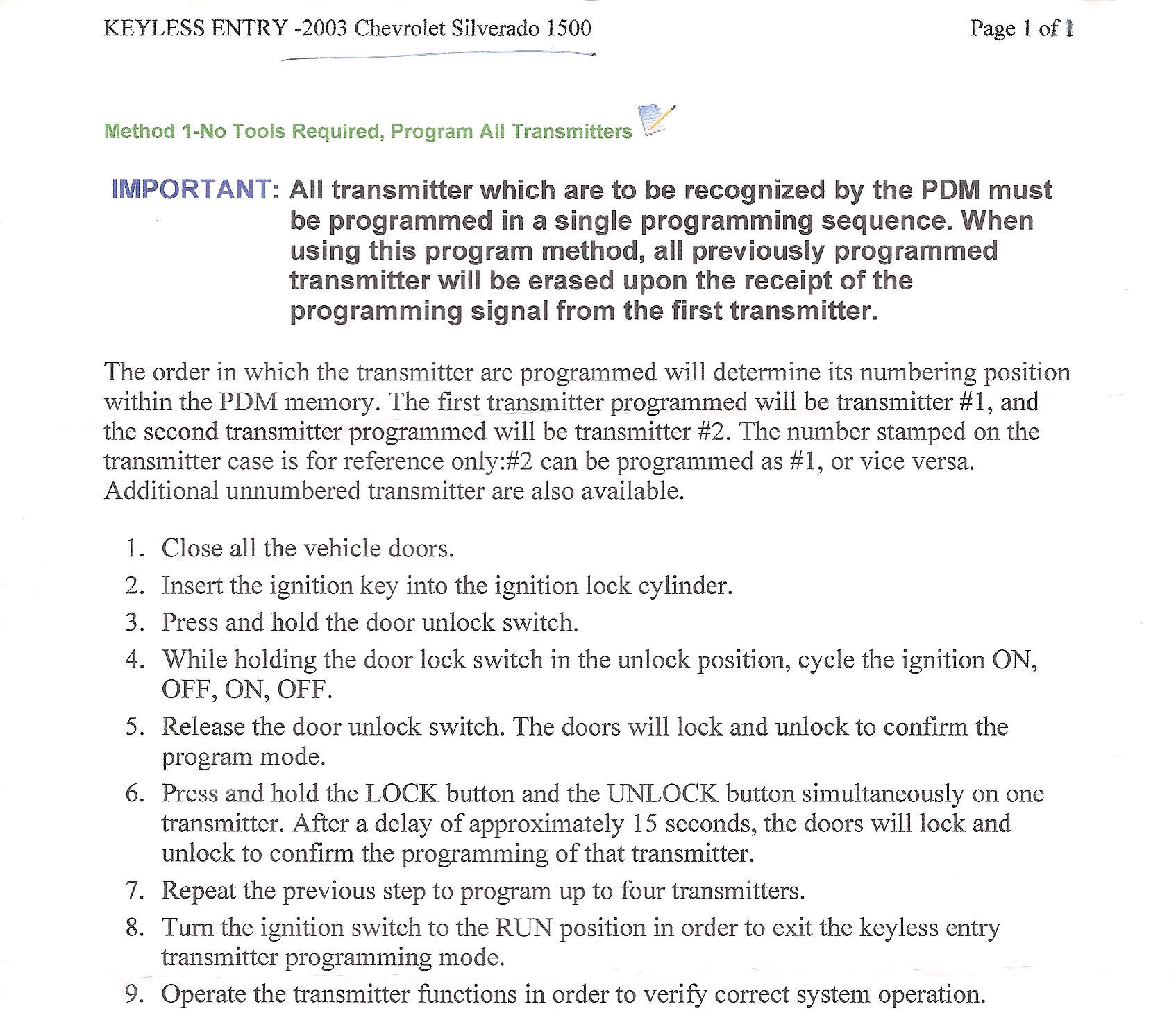

I just bought a '03 suburban and it did not come with the keyless entry remotes for it. I know you can purchase new ones or used ones but I have no idea where to look for the right remote for my vehicle. I've read that the codes on the back of the remote have to match but where do I find this code for my vehicle? Also....anyone have programming instructions for this make and model?
Thanks in advance.
