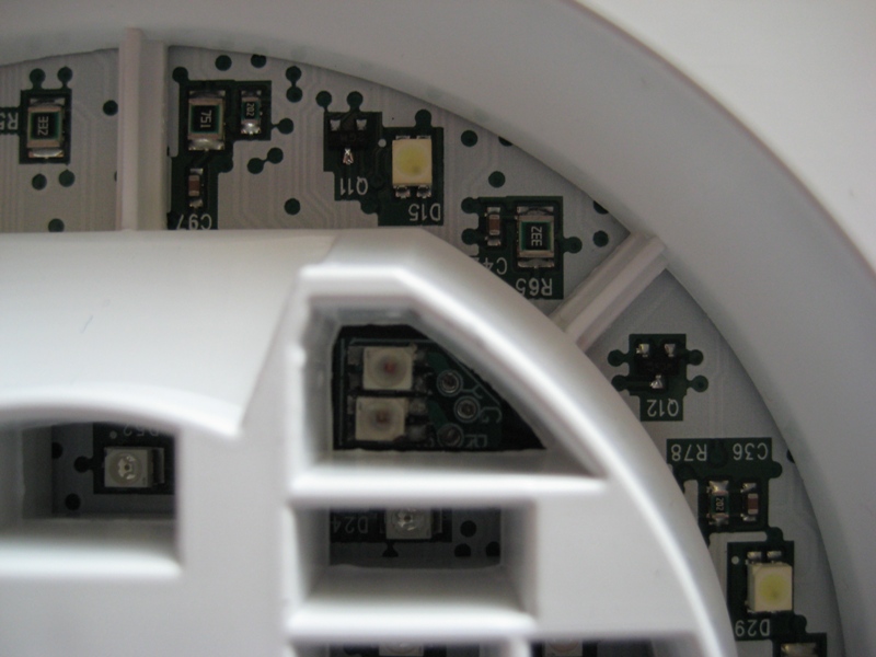

I would need to get my hands on non-auto switch to determine the wiring. The lights are very bright leds but they tie into the LED indicator circuit so if you have auto head lights then these will dim when its dark. With the LEDs I'm using its highly unlikely they'll fail but they can be easily replaced. When you say module, do you mean something that mounts somewhere other then the gauge cluster? Where would you like it to be mounted? I originally deigned it to be as integrated as possible but opening up the cluster is a little involved in order to use the 4x4 light in the cluster.

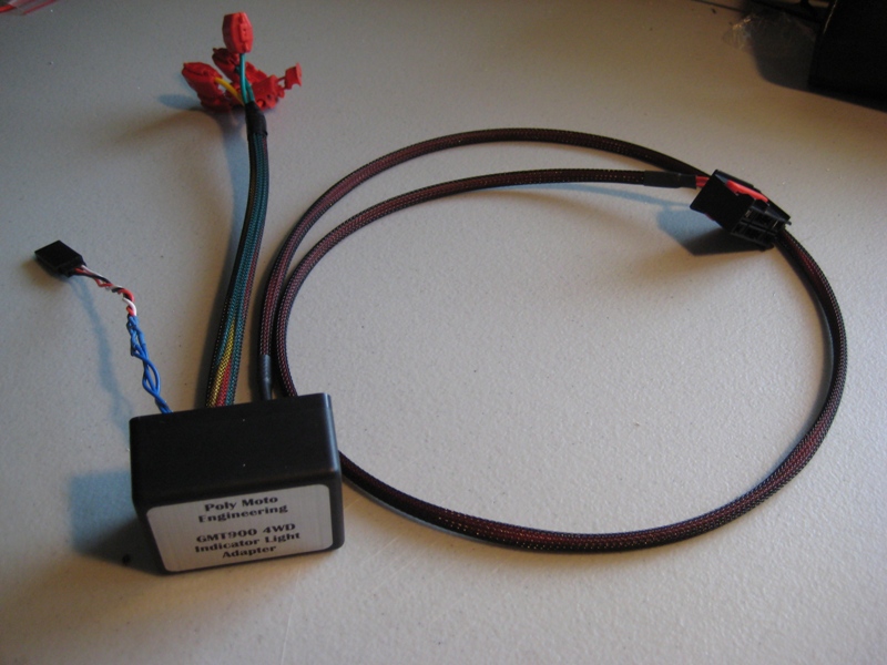

I've been working at developing my original design, something rigged up with radioshack parts, to a proffesional level product that is rugged, reliable, and will last the life of your truck. Sorry its taken so long, I'm kinda of a perfectionist so I wouldn't release anything until it was perfect and throughly tested.
The unit gets its power from the MBEC (junction block left of pedals) using an OEM plug so if you want some extra wires[ground, power, ignition, and RAP(less then .3 amps!)] for a radar detector or GPS, mention it in the the payment. This doesn't cost any extra but if you want to run more then .3 amps RAP then a relay is needed and is $10 more.
LEDs match intensity and color of others in the gauge cluster. Very visable during the day.
I'll be posting a step by step guide in the How To section for install instructions.
Auto 4wd - Yellow for Auto and red for 4H and 4L
Non-Auto - Yellow for 4H and red for 4L

Your kit appears to be EXCELLENT build quality! I'm impressed.
