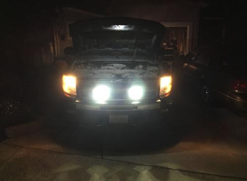

I put some inexpensive, but actually pretty decent lights ( my grill. You can definitely still see that the lights are there, but they are kind of hidden. Unfortunately I am away from my truck for a few weeks for business and all I have on my computer is a picture at night with them on. Also visible in the picture is a light I installed under the hood to make working in the engine bay a little brighter. I will answer any questions and can take more pictures once I get back home.
here's one with just the engine bay lights:

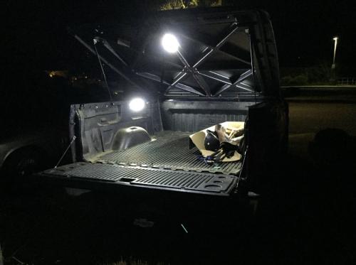

and one of some lights I installed in the bed:
