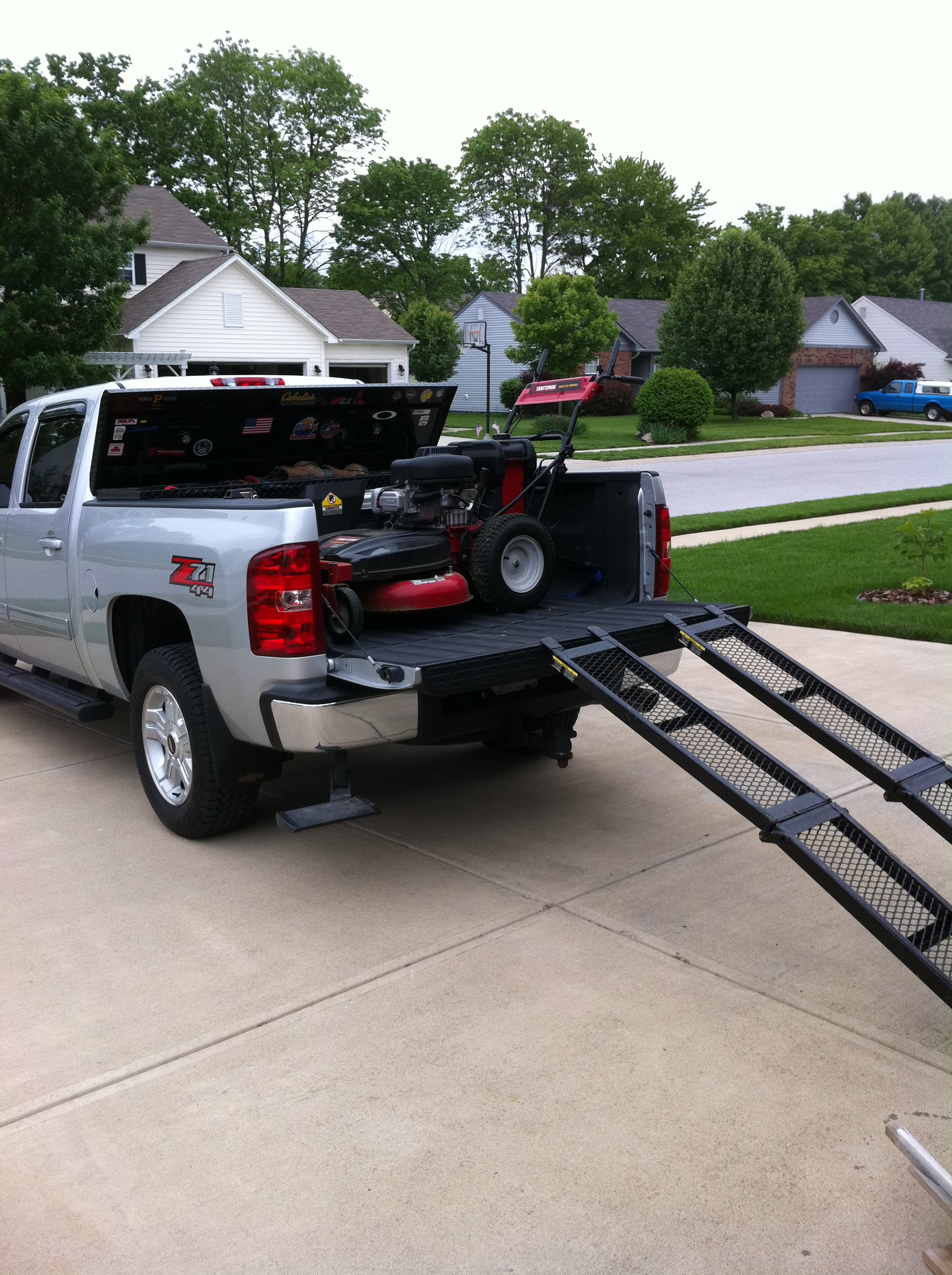

Ramps work great for loading my mower. The tailgate cap has gotten scraped up from general loading wood and such but the ramps have rubber where they sit on the tailgate.
Yeah, i hav a soid aluminum Harbor Freight ramp I use to load my big snowblower on in the winter. Between me and the snowblower we are talking 500-600 lbs. never give it a second thought. Like you my cap is scratched from the ramp. I figure it is a truck and new caps are like $30 if I ever wanted another. its a truck though.
Just a suggestion for anyone using ramps to load, please take a tie-down strap and connect from the ramp to the trailer hitch when loading and unloading. All it takes is for the truck to roll slightly, or the ramps to slide backwards slightly, and you have a dented tailgate at best, and a broken piece of equipment possibly. I heard of one guy that broke his neck loading an ATV that kicked the boards out when he was starting into the truck, and the ATV fell of backwards, flipping on him.
And BTW, I am always amazed at how clean your truck is Ryan.
