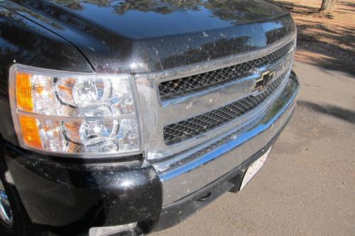

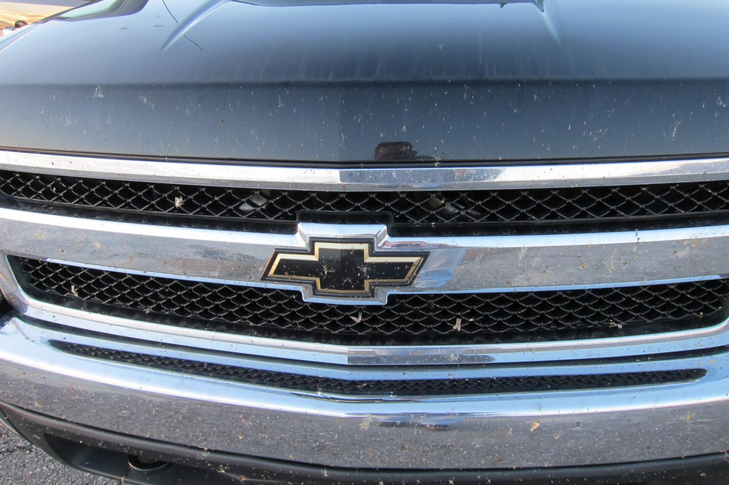

Bug battering ram

Bug battering ram
Ryan
I know the feeling!
3,200 miles of bugs here ...
A few years ago through North Dakota bugs were so bad at dusk made the truck look like it was growing hair up front.
:crackup: Lots of beetles out that way I take it ...
Mosquitos, small black flies. It's why birds migrate back north, to get their fill.
