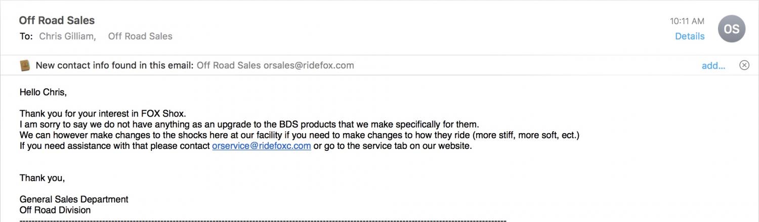

Will those work with our 4-6" lifts? I saw them on Fox's website but they show them to work with a 0-1.5" lift
I'm in the process of trying to find a definite answer. Also looking to see if fox does by chance make them a little longer to fit with our 4-6" lifts or worst case scenario somebody (I think it's ready lift) makes shock extension pieces that allows factory rear shocks to be used with lifts so that'll make them useable
Well, I got an answer from Fox. I asked if their 2.5 reservoir shocks would fit a 4-6" lifted truck.
