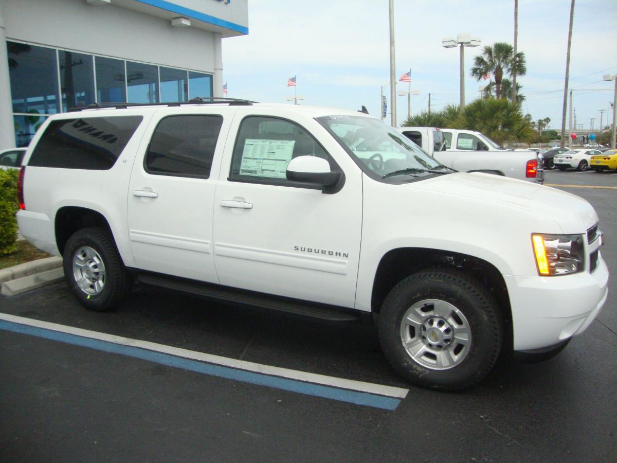

I've been lurking here for a while, and finally took delivery 2 weeks ago of my new 3/4 ton, 4x4 Chevy Suburban.

lets see some pictures of your new ride

PS. How do I attach pictures on this forum? --- OK, I guess I figured it out.
