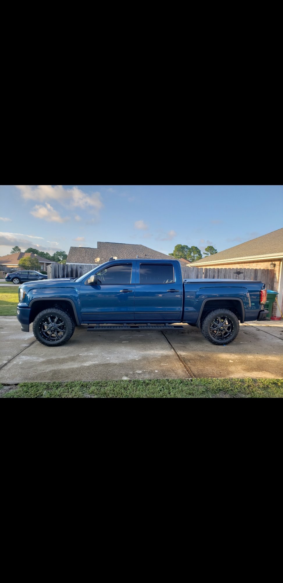

Before. Already leveled with 2.25” pro comp.
After getting 285/65R18 on stock wheels and NFAB side steps for the wife.
Pretty happy with how she came out.
I’ve got same level, added a 1” billet aluminum spacer in rear and made a big difference, may help with your mpg’s too
