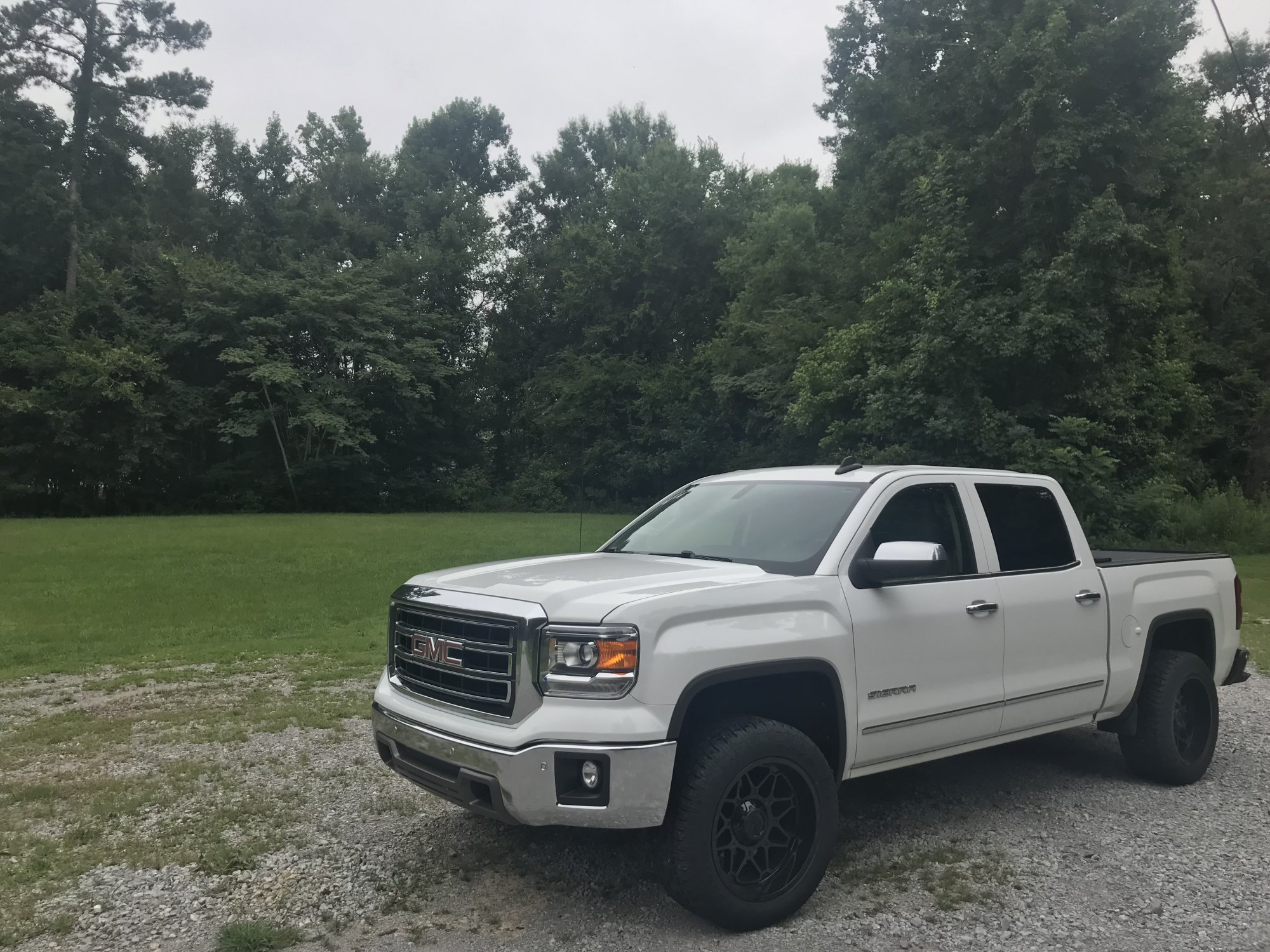

2015 GMC Sierra 2" Rough Country Leveling kit with 20x10 Wheels and 32x11 Toyo Open Country A/T.
What's the metric size on the tires? Toyo doesn't make a 32x11 to my knowledge. Are they 275/60?
When I bought them from custom offsets it was technically 31.9x10.8, I don’t know the metric size off of the top of my head.
Just look at the side of the tire. It has the size on there
31.9x10.8" tire on a 20" wheel is a stock 275/55r20.

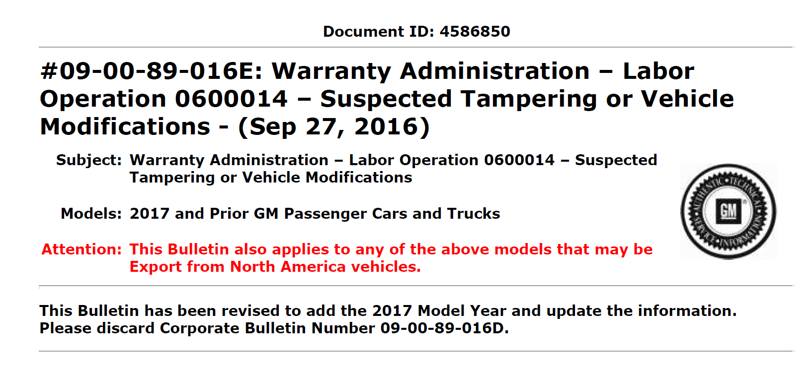

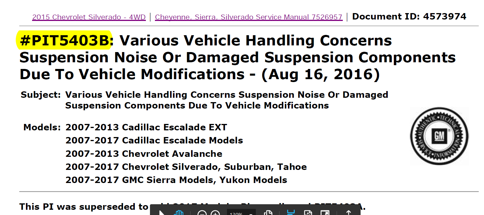

If you are certain you only want 1.5 to 2 inches of lift, then you could go with the Bilstein 5100 struts which do not require any UCA change and actually work within the existing front suspension geometry better than any other solution I know of for staying as close to "stock" as possible and minimizing chances of voiding your factory warranties related to the suspension.  Spacers and new UCAs are well know to GM and they are cracking down on them a bit as mentioned in one of their "KB" bulletins (EDIT:  not "KB" bulletins , meant to say "TSB" and "PIT" bulletins).  The 5100 struts on your model truck will give from 1.5 to 2 inches of lift (they advertise "up to 1.85" inches).  I got 1.5 inches with mine set on the highest level (they have different height adjustments).  Others are getting 2 inches of lift but all are getting between 1.5 and 2 inches like you want.  Further, the 5100s solve the problem of driving off-road and taking dips/speedbumps way better than the stock shocks.   If you do the struts in the front, I would also do the rear 5100 shocks, which is what I did, and love them compared to stock.  I did mine at 4WheelParts (total cost about $750 for everything installed and the final wheel alignment.
Edited by TNAZ
If you are certain you only want 1.5 to 2 inches of lift, then you could go with the Bilstein 5100 struts which do not require any UCA change and actually work within the existing front suspension geometry better than any other solution I know of for staying as close to "stock" as possible and minimizing chances of voiding your factory warranties related to the suspension.  Spacers and new UCAs are well know to GM and they are cracking down on them a bit as mentioned in one of their "KB" bulletins.  The 5100 struts on your model truck will give from 1.5 to 2 inches of lift (they advertise "up to 1.85" inches).  I got 1.5 inches with mine set on the highest level (they have different height adjustments).  Others are getting 2 inches of lift but all are getting between 1.5 and 2 inches like you want.  Further, the 5100s solve the problem of driving off-road and taking dips/speedbumps way better than the stock shocks.   If you do the struts in the front, I would also do the rear 5100 shocks, which is what I did, and love them compared to stock.  I did mine at 4WheelParts (total cost about $750 for everything installed and the final wheel alignment.
Do you have a link to the kb bulletin? And are you saying the bilsteins wouldn't fall under the crack down?
Sorry, I meant to say "PIT" and "TSB", not "KB" (KB is for Microsoft Windows issues).  Anyway, it is "PIT5403B" and "TSB 09-00-89-016E".  The PIT has the real specifics.  I am a factory warranty nut and always have been because dealer work is so costly and parts these days are insane.  However, I really wanted to do some "light" modifications to make the truck more usable and better looking.  I think that technically, even the Bilstein strut would void the suspension warranty in the front if a dealer wanted a way out--this includes bigger tires too and rims with non-factory offsets (I put 33" on versus the 31.5 inch stock tires).  It probably depends on the dealer and the issue--I just don't know the enforcement frequency.  I have not been challenged yet but my thought is that I won't be having issues with the front suspension because if the Bilstein sales pitch is true, I won't be stressing suspension parts like ball joints because it works within the same exact stock spring and does not in anyway overextend the stock suspension (does preload the spring though)--this was the only product I was willing to take the calculated risk on and I saved the original struts just in case.  An even safer play would be to get a GM dealer aftermarket department to put these on--especially the dealer you bought the truck from if possible.  If you go back to the same dealer for work I think they would be more lenient and I suspect that is how most guys are doing this to be super safe or maybe it is rarely enforced.  An even safer play is to get the dealer to add the parts during the new truck purchase--that is my plan for future trucks.
