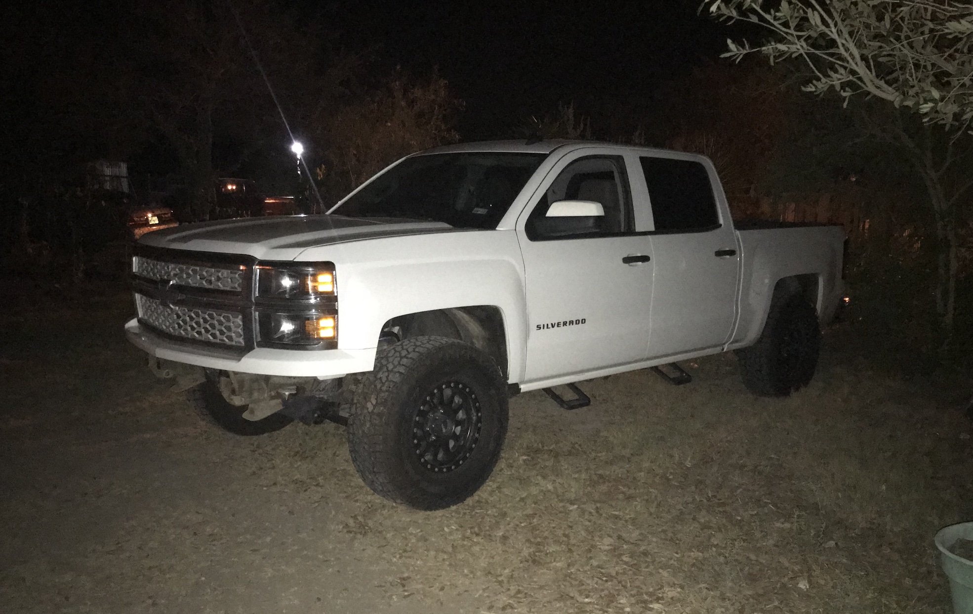

2014 Silverado LT leveled with Falken 35’s on 17’s by Method
Dang! Those look huge! What did you have to do to make those fit? And are they 35x12.50x17 or 315/70/17?

Can you turn the wheels with the 35’s. How much level and how much rubbing
Yes i can all the way. I removed the sway bar and did a norcal tuck to clear the tire but i also removed some of the wheel well liner for extra clearance off road. As far as the level its a simple 2in coil spacer. Later on gonna go with a mid travel kit.

I did a norcal tuck with some wheel well liner taken off and removed the sway bar didnt have to but it feels so much better off road and the tires are 35x12.5x17 yes they look huge on the truck as it sits right now. Currently working on a front skid plate bumper !
