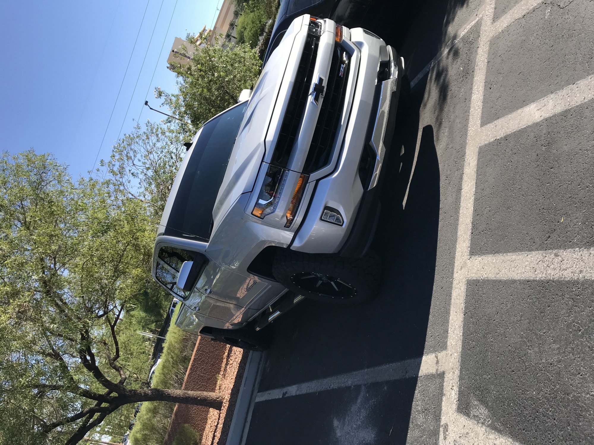

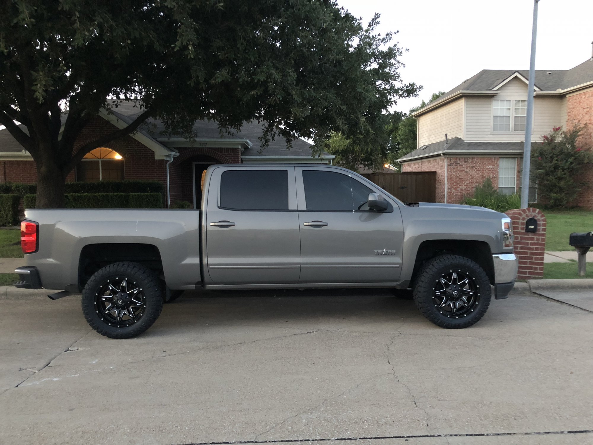

Are there any companies out there that do aftermarket lower arms? Just curious as I don't recall seeing any. I will post a few pictures of my truck for reference. I'm sure all brands vary in how much the upper arms correct the angle of the upper ball joint but I feel like the Fabtech's did a really nice job. The first picture is my truck with the Readylift 2.25" level only. The second picture is with 3.6" lift, Fabtech upper control arms, and diff drop. 3da8a6544d104d8a606b54e1603b7466.jpg0ac75c9a6fff7655d3226cefe728fc6b.jpg

Not unless you go with a midtravel or long travel kit to my knowledge
