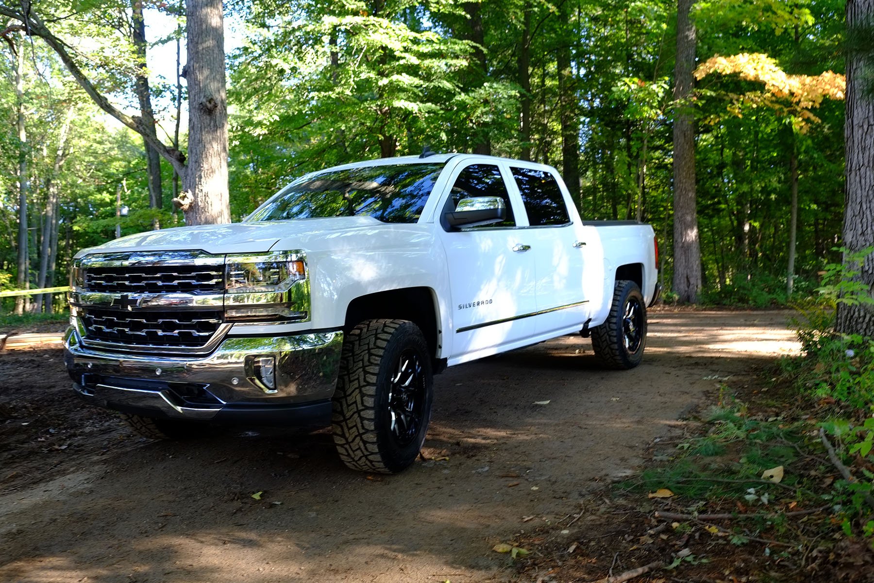

2018 Silverado LTZ 6.2 Max tow, leveled 2 1/2" with Fox 2.0 coilovers, TGC top spacer for the additional 1/2" , Reklez uca's.
285/60/R20 Toyo RT's on 20x9 '0' offset Hostile Rage wheels. Fenders measure 40" rear. 39 1/2" front.
