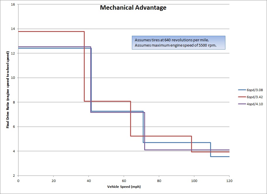

Thread is pretty much dead but I found it interesting. On the original topic I did this analysis to see how the 6spd/3.08 compares to the 4spd/4.10. I also put the 6spd/3.42 in there for comparison. (For all you engineers out there, yes there are a bunch of assumptions in here, nothing crazy.)
Mech%20Adv.jpg?dl=1&token_hash=AAGY_VAIe
The downshift case looks a little bit different. The transmission won't downshift into an engine speed of 5500 rpm. Maybe into 5000 rpm max. Actually, if somebody knows the max rpm after downshift let me know I will make another graph as a reference.
Jeff
