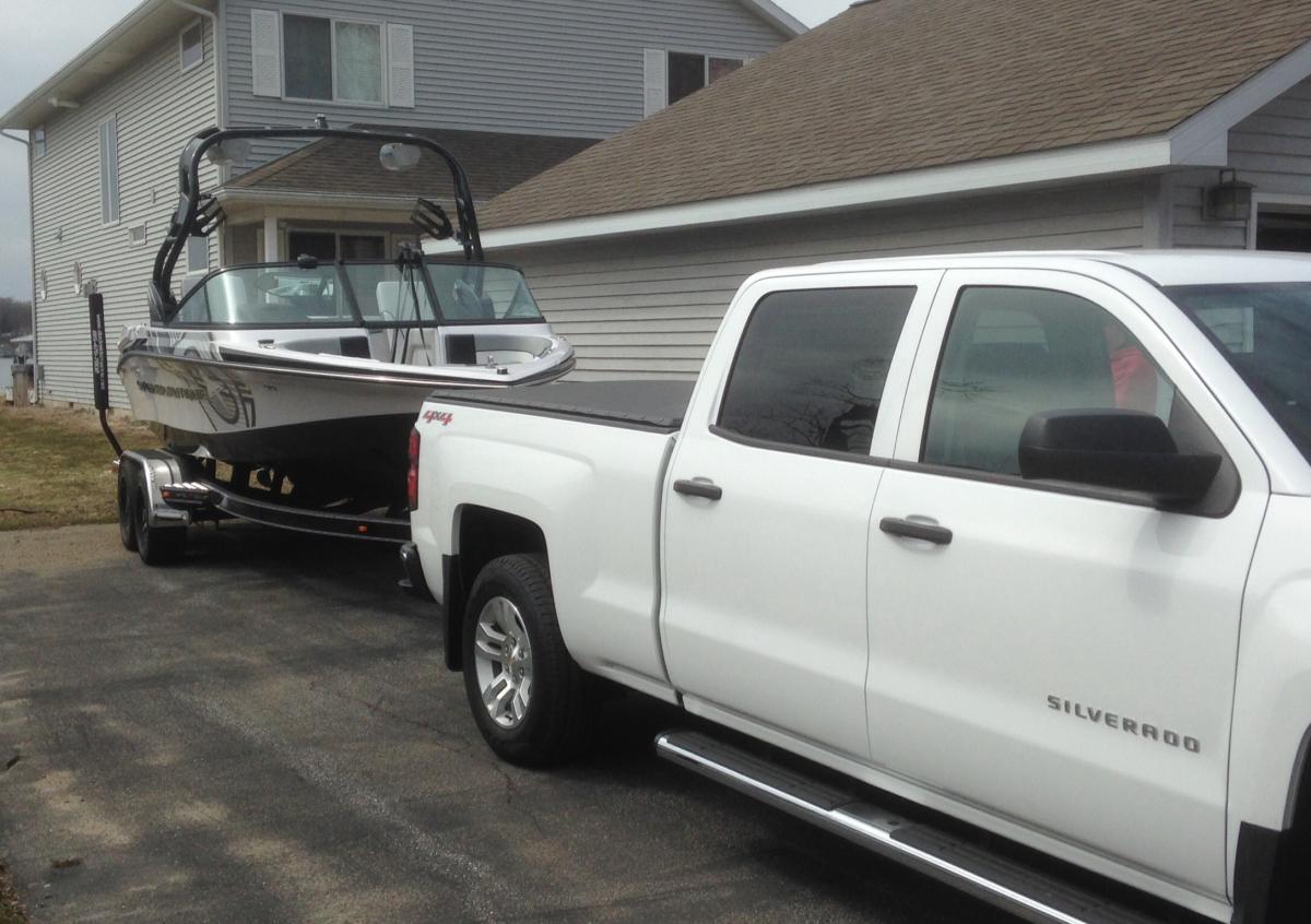

So, I towed the boat about 150 miles yesterday and it went great. Didn't use the tow/haul, not much shifting and once in traffic rolling about 75 it just seemed to get better. Surprised? You bet! Very happy so far.
What's the boat weigh? I pulled 5300 lbs halfway across the country and it pulled like an old 4 speed auto with 3.73's. Took off good, stopped excellent, passed traffic, no sway... I was very pleased with its performance. I also have a 5.3 with 3.08's.
It's listed at 3,800 dry but it's over 4 and the trailer. I read thru this thread and was trying to figure out how to get rid of it but this truck was awesome! I actually think it merged better than my 05 Duramax but for everyday driving just makes sense. Now that I'm sold on its getting Rino Liner, undercoat, fab protector, paint protector and rust proofed today! It's a keeper.
