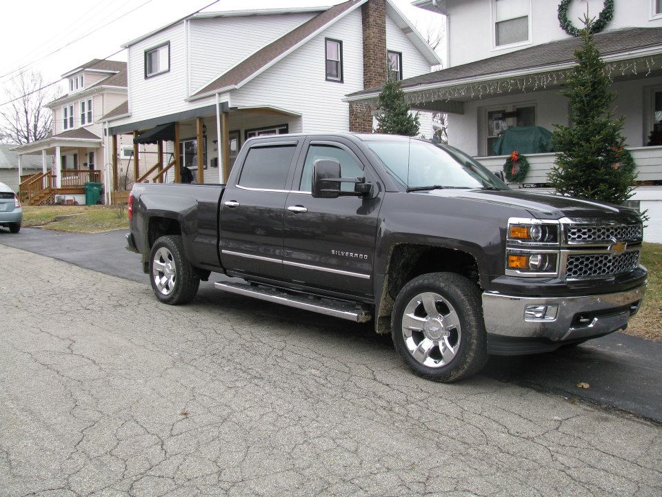

The plugs are the same, the towing mirrors are just missing many of the pins/wires:
Stock mounting:
Drill hole:
I was pretty impressed with how solid the mounting location was. It's not just a couple layers of flat sheet metal, but you can see the contours give it thickness, which gives it strength and stiffness. That's in addition to the wider footprint of the three perimter bolts which spreads the load over a larger area making the setup inherently stronger.
I didn't disassembe the door beyond what I could do with my fingers. I carefully pulled off the moldings, figuring out how they were on there, and pulled back just the corner of the inner door cover. It may have been easier just to remove the whole thing as the plug is down there a ways:
Using long screwdrivers and such, I was able to unplug the old and plug in the new.

Sorry it's so dirty, I still haven't washed the thing....ever.
I'm still playing with the adjustments, but this is a typical view that gives you a good idea:
As you can see, in the flat portion of the mirror the firs thing you see is the maroon car, and it's not even 1/2 way in view. In the lower portion, you can see there's another car in front of it--quite a ways in front of it--in my blind spot.

They don't power fold. The memory and reverse tilt features don't work. They don't dim and there's no puddle light. They basically take the yuppy out of your mirrors. But you can see so much better! Even when you're not towing. And when you are, it should be no comparison, much safer. I haven't towed anything yet but will soon enough.

yes those are the nitto's, factory size 275/55/20 with the lift kit. pictures suck, Ill have some better ones once all my paint stuff is correctly done and on.
Curiosity got the better of me and I went out and pulled back the plastic for a look see at the inside of my door where the mirror mounts. I have a factory equipped Max tow LTZ with the tow mirrors. I can say the inside looks exactly like Jon's does with no noteable difference on the inside. Without pulling the mirror and comparing 2 trucks side by side it would be hard to tell for sure if there is any difference in layers of metal or extra reinforcement on the outside. FWIW mine are rock solid even over all the freaking potholes we have around here.
