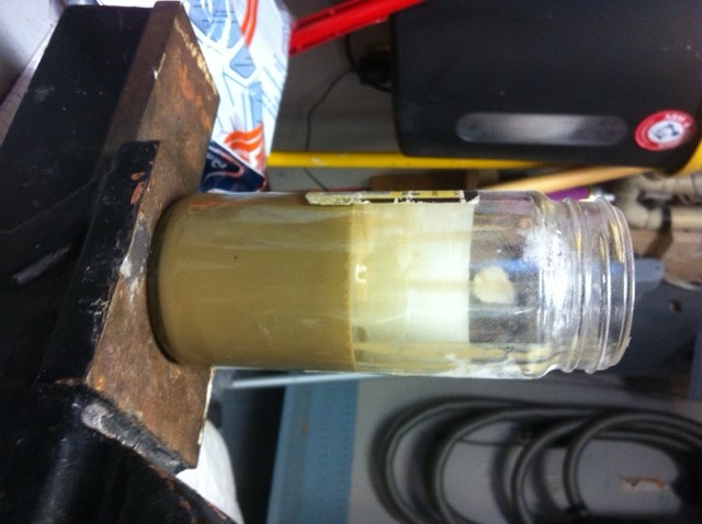

Tonight I drained my Norris Oil Catch can. It had about 6 ounces of a tan coloured oil/water mixture. I installed the can at 1,000 km and this was trapped after 5,000 km. This is going to be a worthwhile investment.post-129625-0-49475500-1416281406_thumb.jpg
