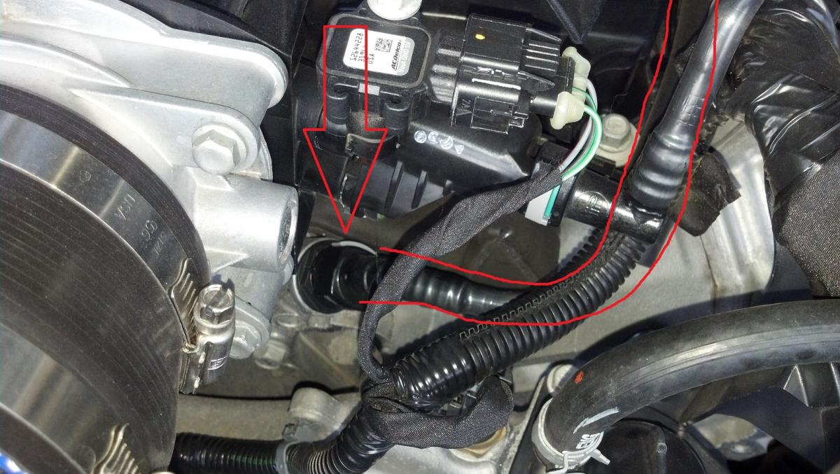

The can doesn't go to either one of those hoses. It connects to a fitting that vents the vapors from the valley area of the engine. Stock with no catch can, there is a hose that transfers these vapors directly into the intake manifold to be burned off during combustion. The catch can goes between this fitting and the intake manifold. The PCV rocker covers are vented into the intake tube (before the TB).
This is the vent fitting on the 5.3 (located under the TB) and the hose runs along the driver side where it enters the intake manifold about half way back.
  • Like 4
Wow, I just watched the video and realized what you just said. The actual catch doesn't touch those two lines on my intake, but there was a separator he installed that does utilize the driver's side hose I was referring to earlier. Guess I know where the PCV valve is now!
Thanks for the pictures too!
