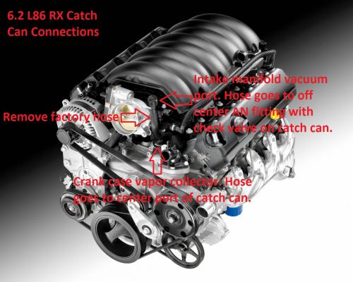

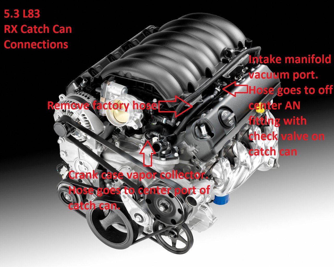

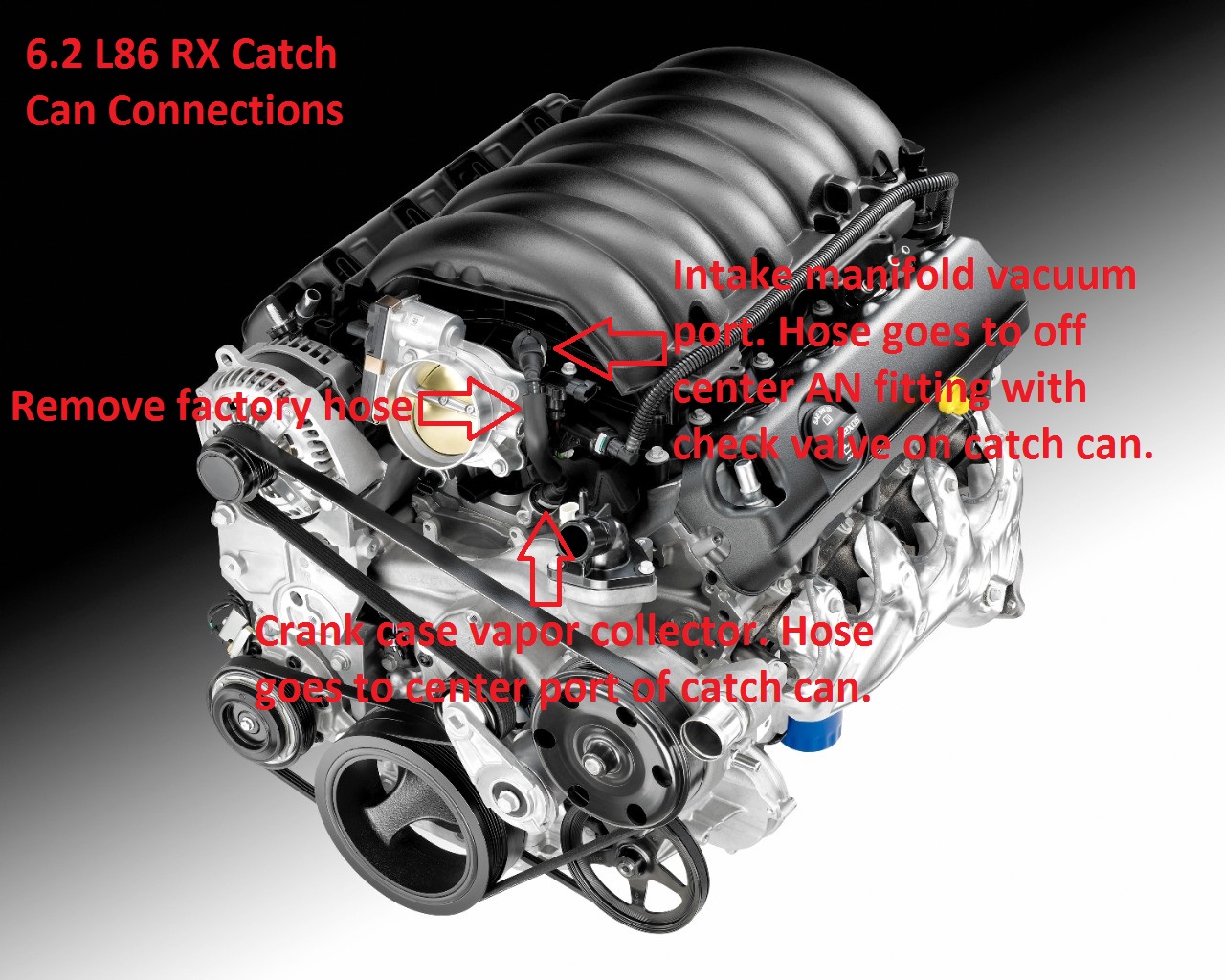

And to confirm the line from the throttle body goes to center. And the line from the middle of motor goes to the off center check valve on the can? Thanks guys!
I found some nice engine photos of the 5.3 and 6.2 and added notes to them.
Both are pics on my 5.3L. I was making it much harder than it was. Very impressed with the can quality, for the price I better be. :) Installed at 2500 miles, for thanksgiving I am driving across Montana to the border and back, and will drain afterwords and report my findings. I did have quite a bit of residue already in my intake and build up on throttle body. The weather has already been below zero a few times this last week so I assume I will have some milky build up as the other pictures have shown. Curious if any of you guys running e85 if you see more or less build up? We don't have it here.
Also to answer the question above, there is no bank on passenger side at all.
Is there not a crankcase vent hose on the other bank? If there is, why is everyone only doing the 1 bank on the driver side?
No vent hose that I can see on the passenger side bank.
I run E85 almost exclusively. I installed mine at about 3,500 miles. Not really build up but some discoloration.
Excellent post gone_fishing. That should easily answer any future questions.

The routing of your hoses looks different than this 2014 Sierra:
What's the difference that I'm missing? Is one a 6.2L vs a 5.3L?
EDIT: Nevermind the first user comment under the video explains:
Thanks for the vid. I just installed mine on my 2014 Silverado. Note: This video appears to be for a 6.2L.
The 5.3L has the dirty side manifold port on the driver side of the manifold about half-way back. Also, the inside of the manifold is a straight tube about half-way inside. There isn't any way to see any puddling oil or get to it if you could see it. My truck has ~3k miles and the throttle body did look about as dirty.
