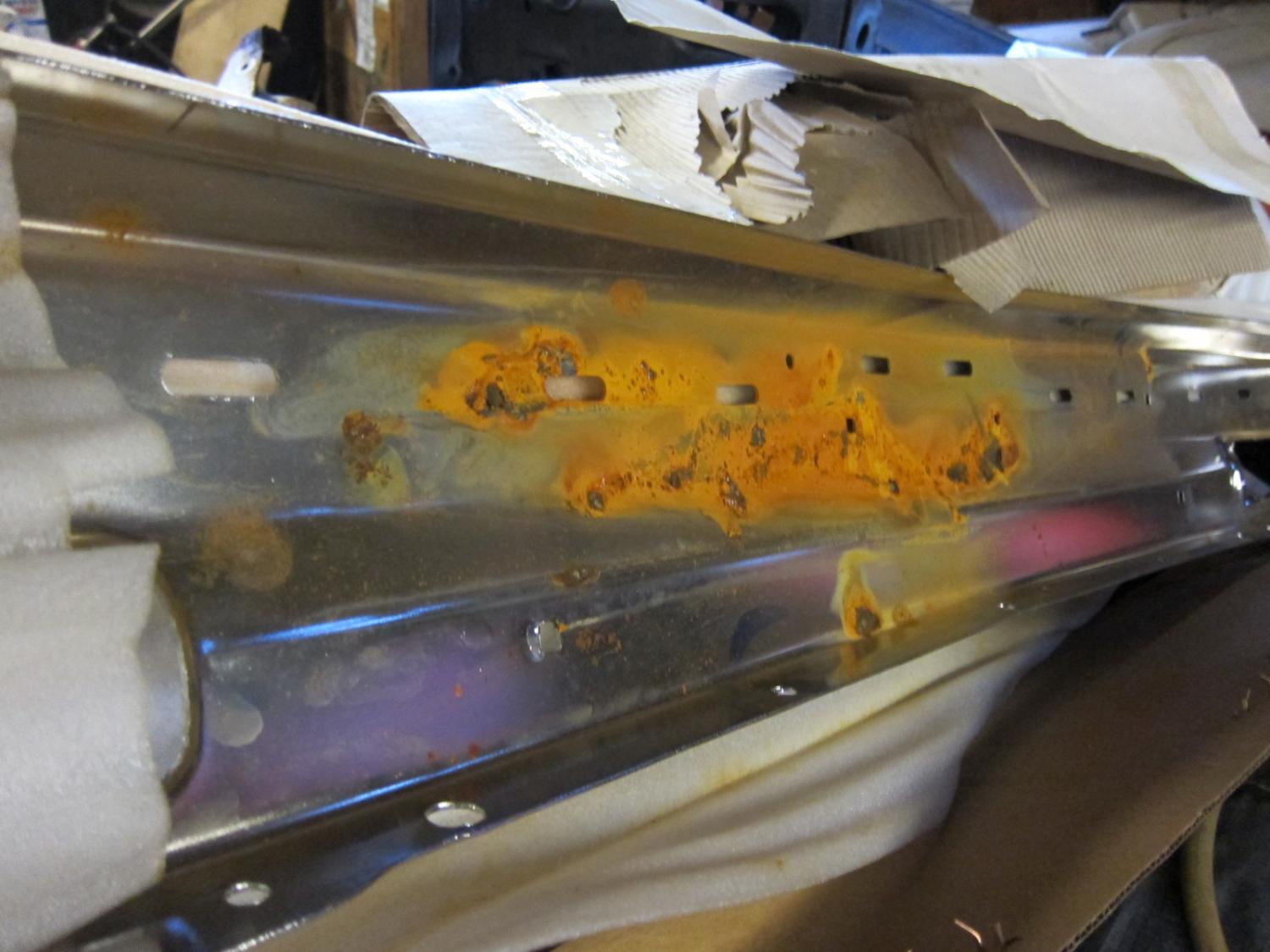

Then there's the chinese bumper I bought for our '89 S10 Blazer off eBay, after the wife cranked a guardrail this winter. That got sent right back - had more rust than the 26 year old OEM it was supposed to replace! I ended up banging it back with a sledgehammer and just running it dents, cracks and all.

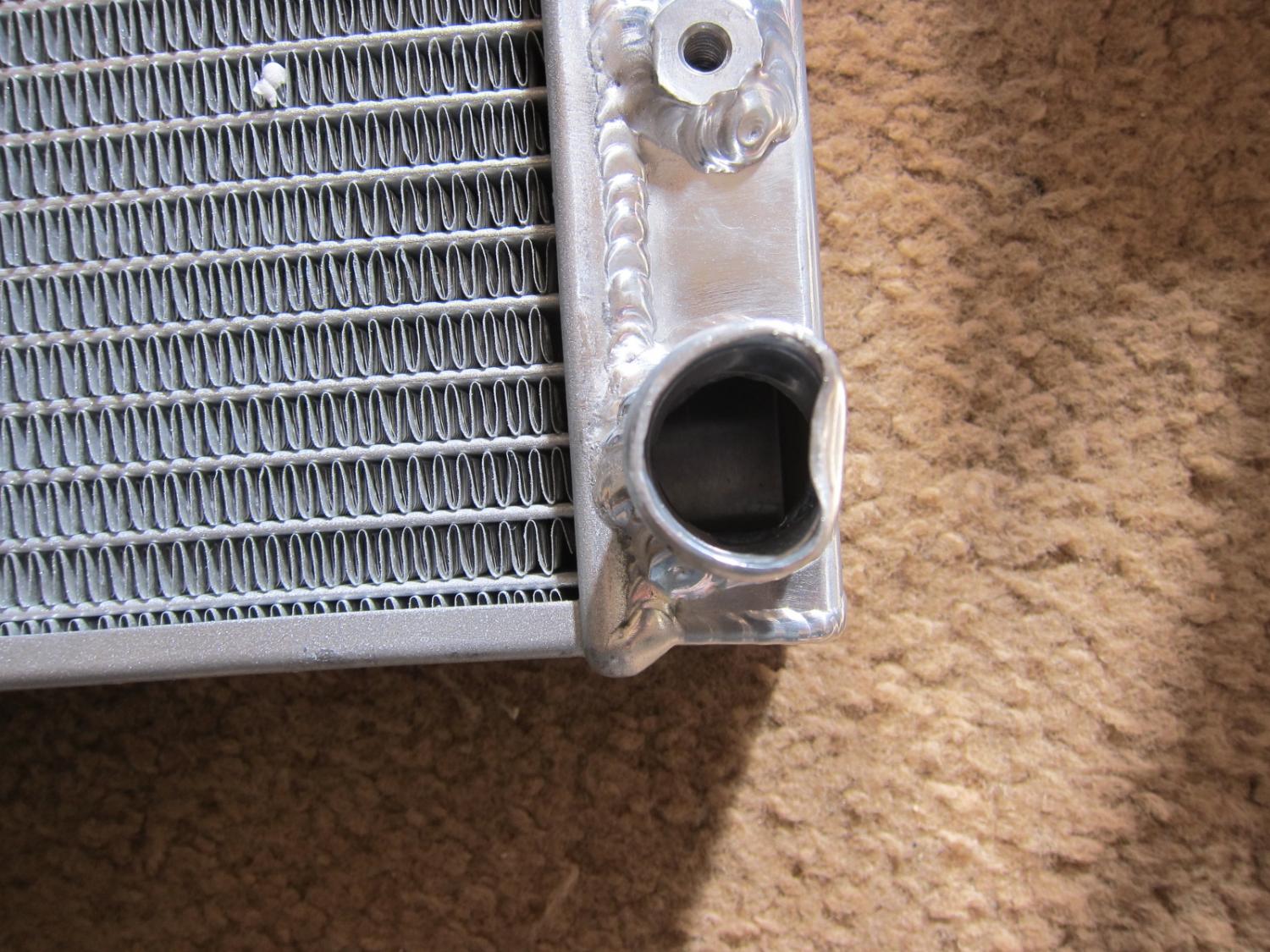

Bought chinese CV axles for my Polaris Sportsman 800 - got 210 miles out of them when one outer CV broke in 2, and the opposite side twisted (ready to break). Also bought a radiator for the same machine - thing was as strong as lead solder! Was all bent when it arrived. They told me to keep it and refunded my money! LOL - goes to show ya ...
