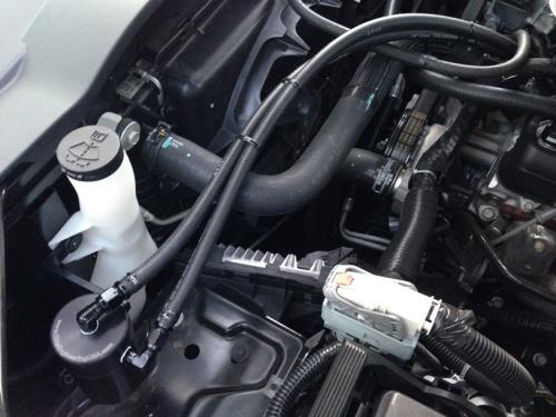

I rerouted the lines on my catch can and moved it from the brake booster to the spare battery tray to get rid of the buzzing in the pedals and voila - gone! Pretty happy with how it turned out. Was worried about lines all over the engine bay with the long runs over to the tray but found out a good way to route them and think it turned out pretty clean. Pics below:
Looks like they put the washer fluid fill neck right in your way on the new ones.
In my opinion, longer lines are to your benefit - the longer the run, the more the mixture cools off and condenses and finds itself in the catch can.
Just took a 2+ hour drive today - the catch can hoses & the can itself (located on core support in front of battery tray) were barely above ambient, while the engine and everything close to it was blazing hot.
Good to hear, yeah I think this will work out in the long run too. When I got home from work yesterday and was going to tackle the project, the catch can was pretty hot (mounted to the brake booster) along with all the lines which I expected since its in the engine bay in FL where its 90 deg already. With the new location in the battery tray it should be cooler as well as be a whole lot easier to check and dump the oil.
Looks good!
