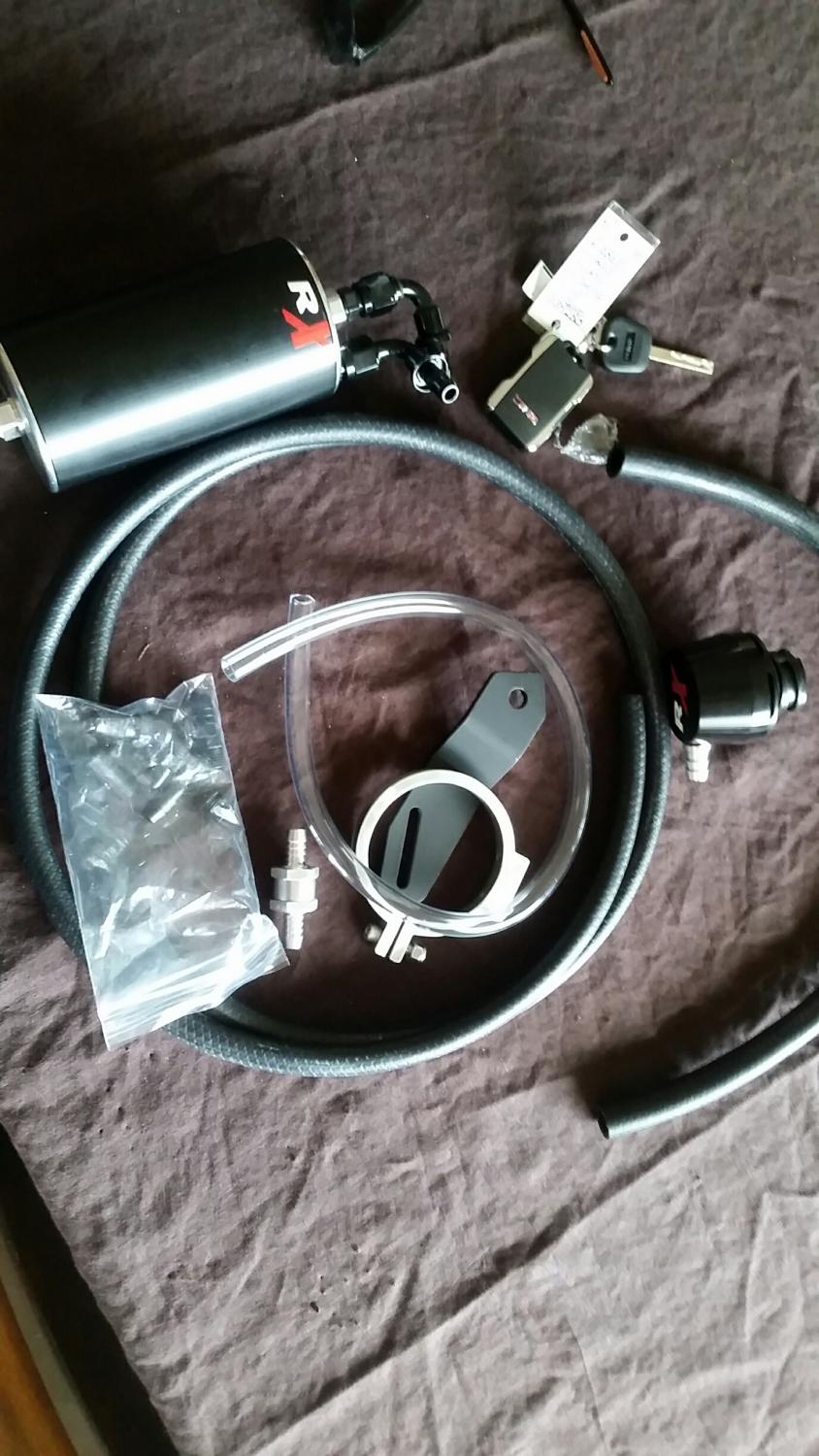

My Rx can came in yesterday. I decided to read through the thread again. Looking at some pictures it looks as though the check was redesigned, I'll post pics of the kit later. My slight concern is the size of the can and the hose lengths provided, which the latter I can just buy more if needed. It was right after I ordered the can they advertised the monster can being recommended in colder climates which is a fact of life in Canada, being as meticulous as i am if i keep the smaller can ill be draining every week in the winter for good peace of mind. I'll probably run this through the summer and see how it works.

Attached pic of the kit.
There's this silver clamp that isn't in any previous pics I have seen in this thread.
You can also see the silver check valve by the bag of fittings that's also different looking than others in this thread.
