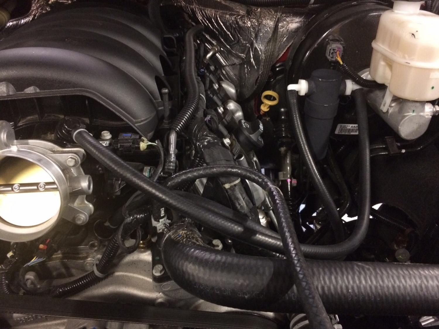

What about the two vacuum line on the front of the valve covers on the left and right sides that go into the intake tube should they also go threw a catch can ?
No, those are what you would handle with a clean side separator. The valve cover lines mainly pull air when the engine doesn't produce much or any vacuum (i.e.; WOT). The aftermarket clean side separators tie these two lines together and route the air intake line to a custom pseudo separator that installs in the oil fill cap.

Edit: I've not seen anyone do a home made clean side setup or use a catch can on it. I wonder if there would be too much restriction for a full blown separator on the clean side to function properly. I have the Elite CC and I'll probably get their clean side setup too.

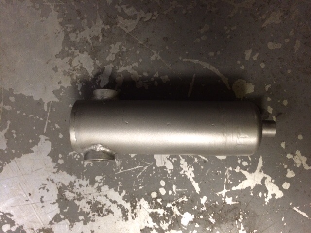

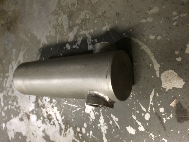

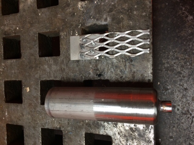

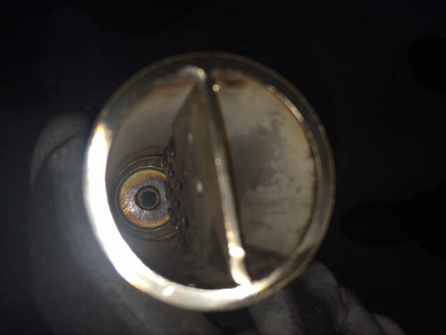

Looks to me like all it has in it is steel wool or something like that basically a its closed loop breather ?
