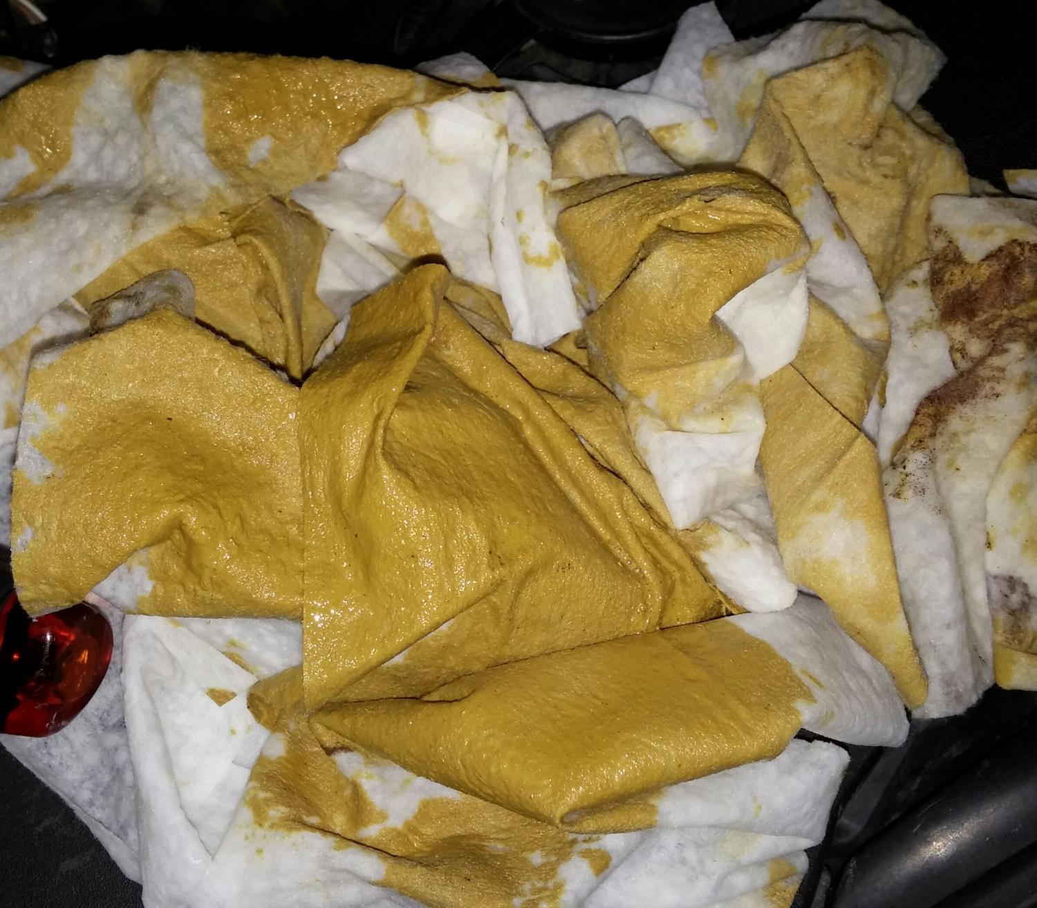

What my truck looked like today back to being just oil mainly and a very small amount
Ryan
As the temperature of air rises, it can hold more water vapor before it becomes 100% saturated.....
Wow it does hold a decent amount more. Make sense. Thanks.
Just keep in mind that motor oils are hygroscopic and will hold water in solution. From what I've read, synthetics will hold more water than mineral oils. At what percentage the water becomes visually apparent is beyond me. I know water, air, and oil mixed up well, make a light colored froth.

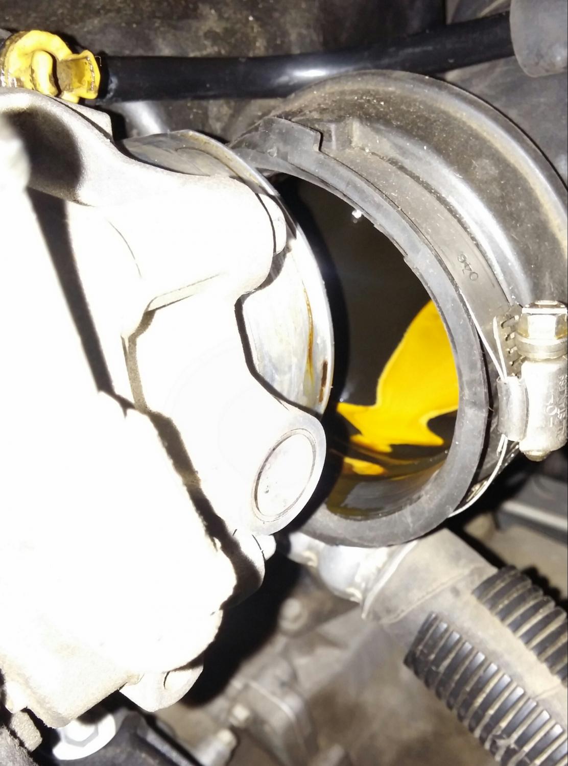

As do I. And if you haven't experienced what that frothy mix can do take a look at this pic.
Now this isn't a truck but but was my wife's Acadia which I think still shows a good example. The PCV hose dumps into the middle of the air duct going from the air filter box to throttle body. You can see the frothy mix pooled in the duct and the throttle body directly to the left. The MAF sensor is to the right of the pooled froth. Once I discovered it collected there I'd have to clean it out every week or two in the winter. Probem was, at least what I suspect was happening, was when you punched the gas petal this froth would get sucked into the throttle body as the vehicle would stumble and shutter under most WOT situations. It would also randomly throw check engine lights. The MAF sensor went bad, again my suspicion was that this froth sloshed backwards possibly while going around corners etc and came into contact with the MAF sensor eventually ruining it.
This I now refer to as GM's cheap version of a crappy catch can. It may work fine in warm climates but not colder ones like where I live. I would rather play it safe and try to prevent a lot of this from getting to the engine than be sorry with my new truck.
U guys had me curious so I pulled my air lid/filter apart to look down the Tb. I have 8700 miles and I don't have any oil in the tb or in the intake. Wonder if it's location difference or driving habits or something totally different that is effecting more vehicles than others. And I didn't clean it before taking the pic. I also looked at my wife's 13 GMC Terrain that is di has 25k miles. Intake had very little coating of oil like if u sprayed a little cooking oil on something

On our trucks, there are 2 hoses going to the air duct between the MAF and throttle body. They are supposed to let air into the crankcase. The PCV line is connected to the manifold where there is high vacuum.
On your wife's car, it sounds like it's the same design, but maybe the PCV is plugged/stuck?

Nothing was plugged, made sure of that many times, as did the dealer. There was this one on the front side of the engine and on the back there was another. Poor design on GM's part. You can't convince me otherwise after what I've seen and experienced on that model. I just think GM has developed better ways to handle this on the newer vehicles. Live and learn....
Do you have a 5.3 or 6.2? If 5.3, you won't see oil at the throttle body and intake because the PCV line is connected to the driver's side valley cover about halfway back. My throttle body was spotless on my 5.3 but my catch can is catching all kinds of crap. It's not just affecting certain models it's all DI engines regardless of make or model and Toyota seems to be the only manufacturer to attempt addressing the issue by designing a system that periodically sprays fuel on the back of the valves. While that may help clean the valves, it doesn't do anything to stop this crap from entering the engine to begin with though. Only a catch can will do that. After seeing the results of my can, I'm sold on using one.
