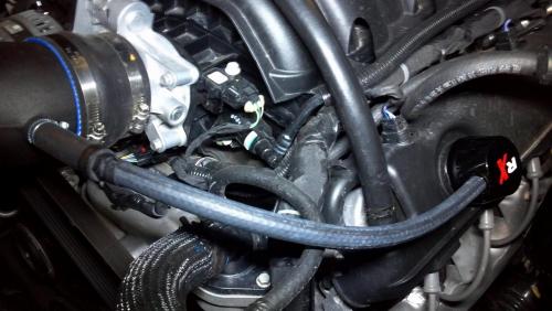

When I originally installed my RX catch can, I didn't opt for the clean side separator they offer. After finding oil in my Volant CAI tube (http://www.gm-trucks.com/forums/topic/168584-oil-in-intake-tubeanyone-else-check-theirs/), I decided to install their clean side separator. Per Tracy at RX, I was told add a hose that basically connect the two valve cover breathers together. The clean side separator goes to one of my intake tube fittings and the other fitting is capped. RX instructions: https://www.rxperformanceproducts.com/wp-content/uploads/2015/03/CLEAN-SIDE-SEPARATOR-INSTALLATION-INSTRUCTIONS-FOR-ALL-GM-DIRECT-INJECTION-V8.pdf
^ So this essentially only helps for WOT scenarios? Are they fairly simple to install?
The clean side separator from Elite or RX are basically the same setup and very easy to install.

The RX and Elite CSS both draw air from the oil fill cap, driver side valve cover and supply it to the air box before the throttle body. The 2 ports on the valve covers are connected together so this gives a path from both covers through the CSS to the air box. But the CSS keeps oil from being drawn into the air box.
Alright i'm missing something. In the stock set up, both valve covers have their own hose that connects to the air box on their respective sides of the air box.
With a CSS set up, the valve covers are connected together, the passenger side port on the air box is capped, and the driver side port on the airbox is connected to the clean side separator. The draw of air from the valve covers to the airbox is eliminated so what happens to the air in the valve covers...it just sits there and doesn't need to be evacuated like the crankcase gases do to relieve pressure? How can you just connect both valve covers to each other like that?
OK, I'm obviously not being clear. The CSS draws air from the driver side valve cover via the oil fill cap hole. It does not draw in any outside air. Think of it as replacing the orignal driver side vent hose that goes to the airbox. The difference is that there is now some stainless material in the CSS that captures the oil leaving the valve cover. The original passenger side vent hose that went to the airbox is replaced by one that goes to the driver side valve cover.
It is still a closed system that connects the valve cover to the airbox using only one hose that runs through the CSS instead of
directly into the airbox. It maintains the passenger valve cover connection by routing it to the driver valve cover.
Hope that helps.

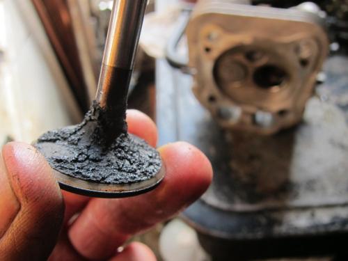

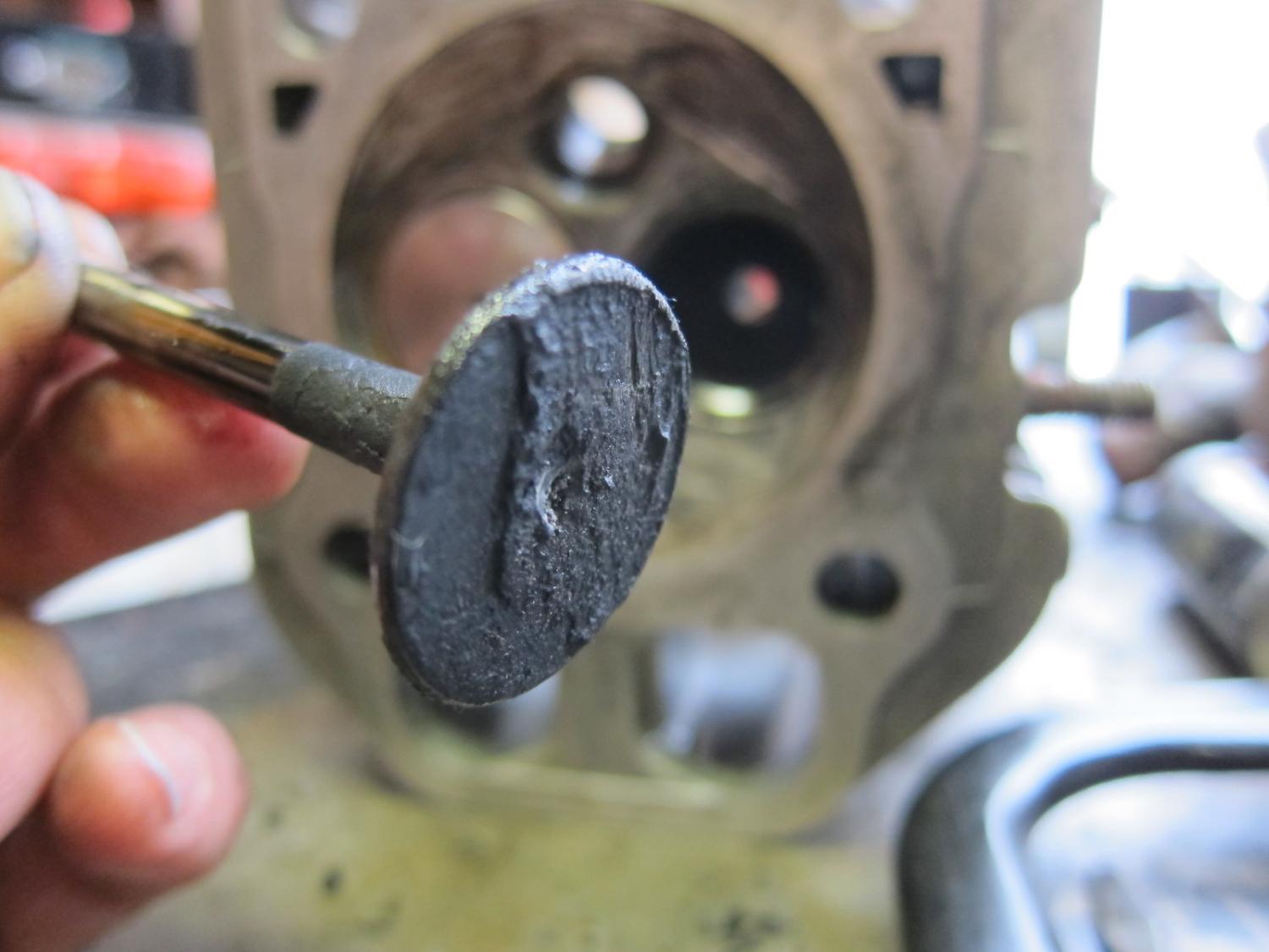

I just visited my dealer and talked to the shop foreman about Catch Cans. He is telling me those won't help with carbon build up on the intake valves. He says carbon is a by product of burning gasoline and that the Intake valves will get carbon build up regardless of whether you run a catch can or not. He says it's recommended every 15,000 miles you use an intake cleaner...
Still think I'll run a Catch Can.....
He's right ... but oil will add even more, bigger, & goey-er buildup.
Here's an intake valve out of a Kohler CV730 v-twin lawn tractor engine that burned oil (at 160 hours - former GM engineers working there? :lol: ) due to a faulty OEM installed head gasket. Just imagine how bad this would have been without a carburetor washing most of it off!
