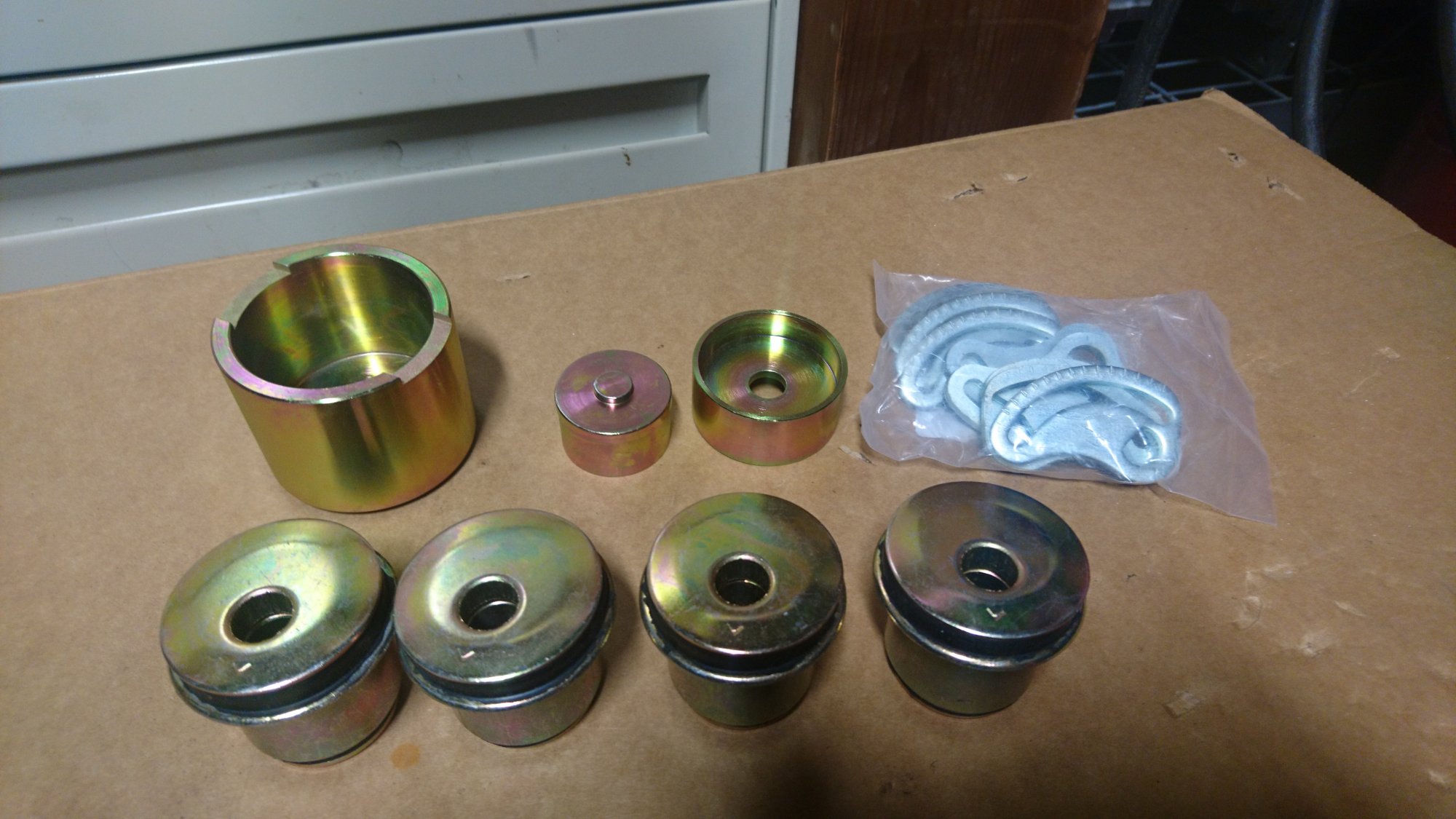

I got my offset control arms bushings in today. The kit came with the removal and install tools which is nice, just need to have a ball joint press.
I think I'm going to bring it into work tomorrow and throw it up on the alignment rack to see how close I can get it with the stock bushings.
Were all of you able to get camber in spec at 4" drop in the front?
I'm pretty sure I'm going to take the 10mm rings out from under my spring cups to get the front down another 1/2" or so and then put the rear at 6".
