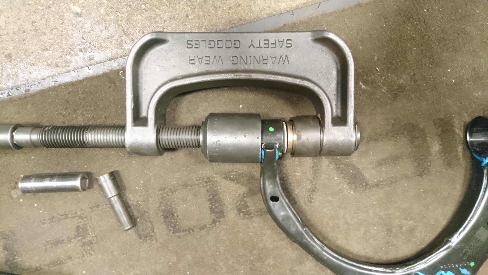

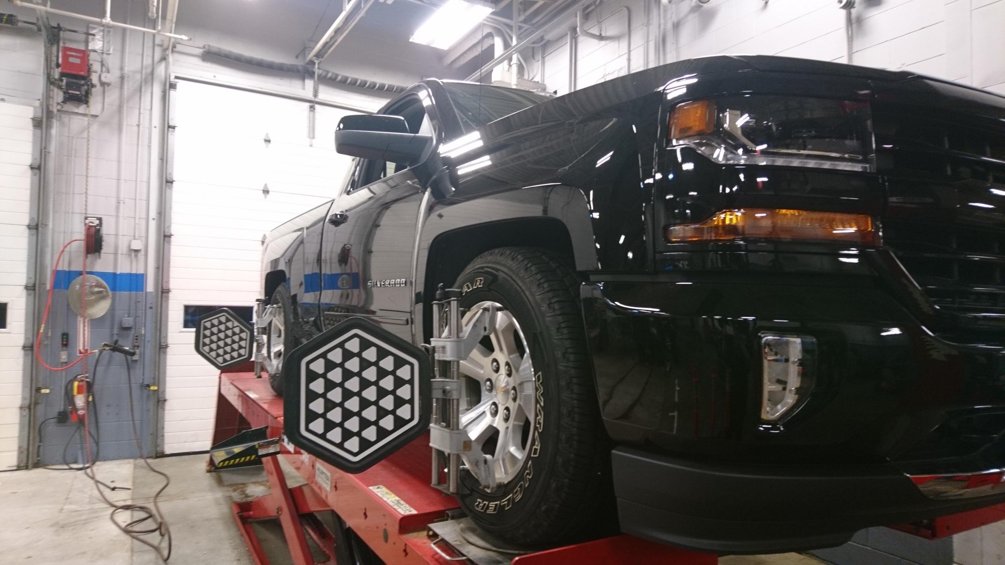

I had 2 hours after work to tonight to try and get my bushings in, remove the 10mm rings from the drop shocks and get an alignment done.
Let me tell you, these bushings were miserable and fought me the whole way.
I had to use a combination of the adapters they came with and the Snap on ball joint press adapters the get them out. The press adapters didn't want to stay straight and it wasn't as quick as I thought it would be.
Putting them back in was imposs9with the press and I had to pound them in with a hammer and the install adapter they came with. And they were tight. I measured my 9" between both and put them back in.
It took me an hour and a half to get to right side done so I only did one side, since I had to align it before I drove an hour home.

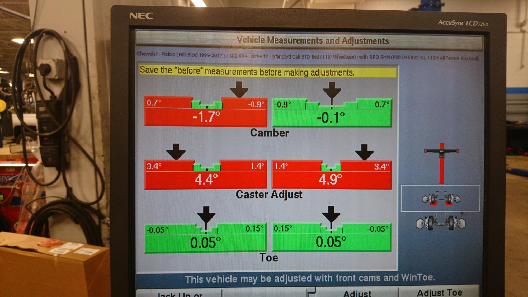

I set the rear adjusters to the full out position and the fronts to the midway position before the alignment because that's how the they were previously set. After I measured everything  the right side camber was dead nuts on and the left was - 1.6.
I decided to just set the toe for now and go home since I had no more adjustment on the left side.
Oh, and with the 10mm out of the right side but still in the left side my front is the same height now left and right, so I'll probably leave the left strut alone.

Here's what my specs look like with just the toe set for now
and the set up for pressing the bushings out
