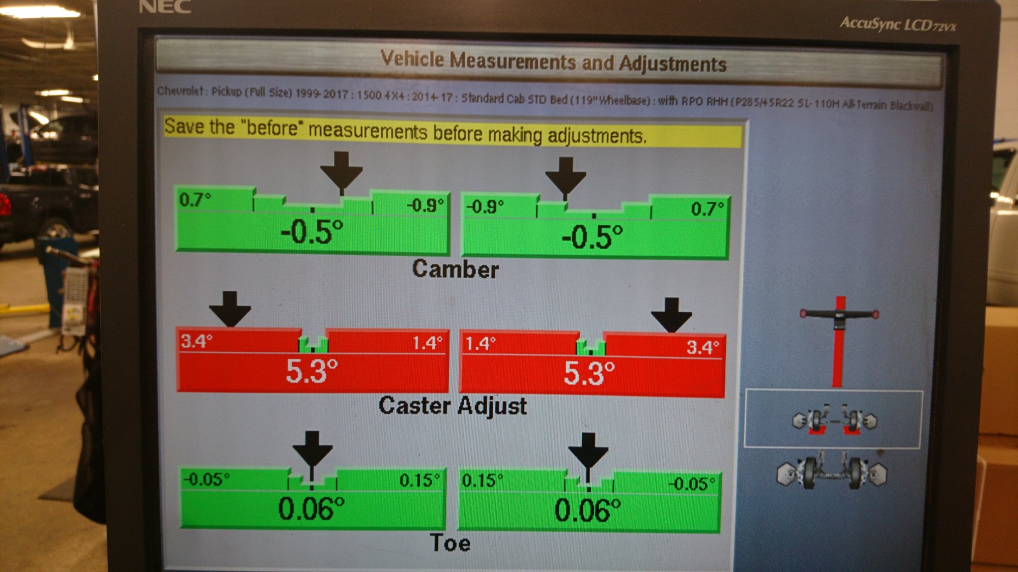

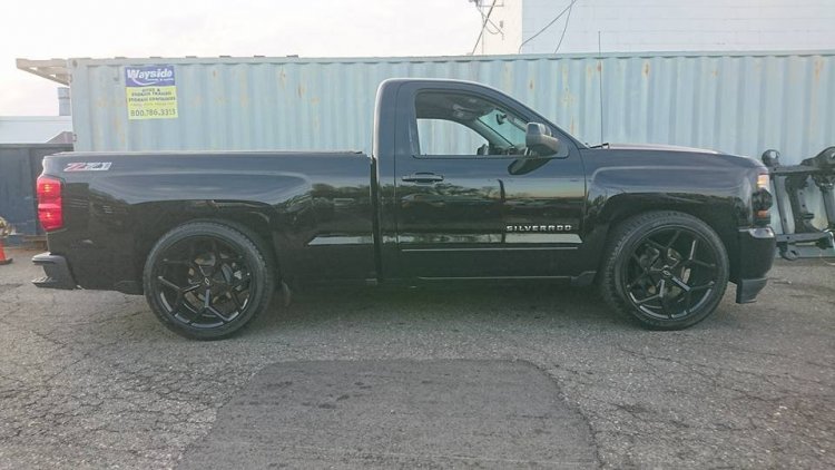

Well the right side was dead nuts on but the best I could get the left side was -0.5 so I adjusted the right side accordingly. My caster is wicked high but like I said, that's not necessarily a bad thing.
Truck rides nice and drives straight, I think I'm done messing with the suspension. On to the next project. DSC_0862.thumb.JPG.b05fac0616fa3a79865689177d37fd2f.JPG

you were right, I took the back down to 6''.  this time I'm done for real now though :lol:
