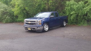

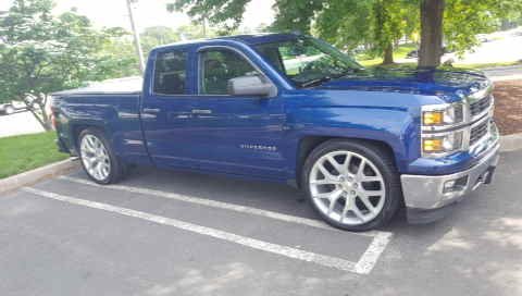

1527365087272.jpg.b6b2bf2932d42acbf289203065a50a63.jpg1527472242080.jpg.ff8dedd5de32c2f87ef56292d8da20d7.jpg14 Z71 4x4 Lowered on 3/5 Maxtrac kit.  Wheels are 24x10 oe reps wrapped in 305x35 24.  Had to trim fender liner, and rubs slightly on big bumps, otherwise runs great.

what was used to lower the front, struts, springs, or both?

I'm pretty sure maxtrac is spindle and coil spring

Yup, spindle and drop springs up front,  flip kit and shocks in the rear.
