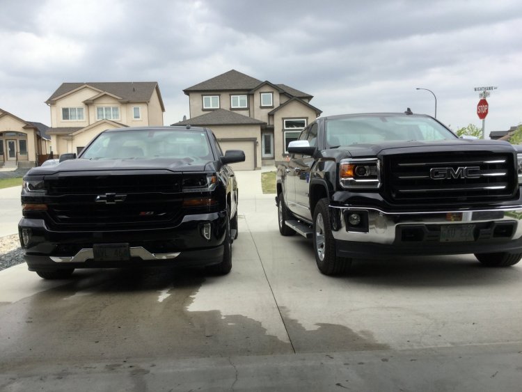

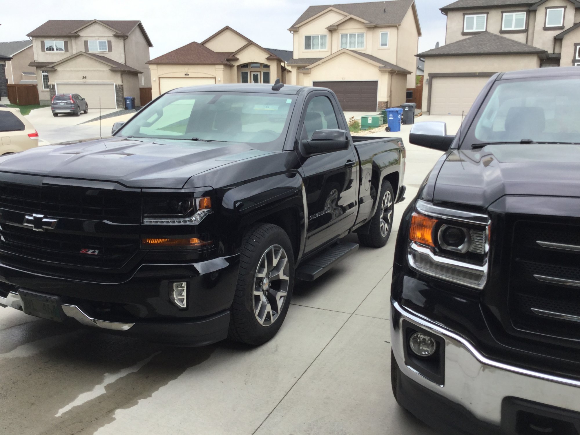

204-WPG, are you at 2/5 or 3/5 in these photos? Thx
3/5, I suppose.
But maybe these measurements will be more useful to you...from the center of the hub to the lip of the fender....front is 19” and the rear is 20”.
Note that these pics were taken right after the install and the driveway is going upward so with the truck being parked.
I just noticed that after a while of driving, the front is now a bit lower thus has settled already., in fact just now, I took those measurements I mentioned above.. Perfect for my liking, The 275/55/20 stock tires are not rubbing even when making full turns. Really close but still with just enough clearance from the fender lining. Note, if I were to buy 22’s later, I will seriously be considering to use the 285/40/22 tires over the 45 profile.
hope these info helps.
