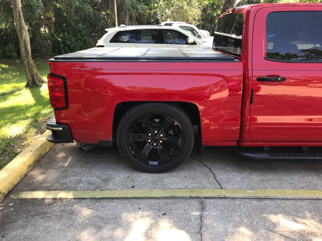

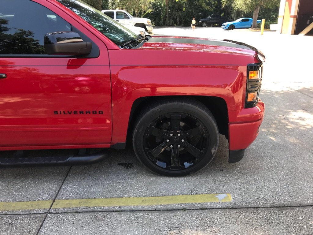

Need some input ASAP.  I finally pulled the trigger on getting my truck lowered.  I am having a reputable local shop install an Inez 3/5 lowering kit.  The front is looking good, though I am getting some rub.  I thought this might be the case and expected it.  What I didn't expect is that the rear is coming out an 1" to 1.5" lower than the front.  On top of that the shop told me that even with the bump stops completely removed the truck is bottoming out on anything more than a small bump.  The rear was only supposed to drop 5" and apparently it is dropping more than like 7".  The shop installed the flip kit , 1" lift shackles and included shocks.  Anyone have any issues like this with a flip kit?
A tiny little temp relief would be to take out your spare. That will get you a half inch or so since it's added weight behind the axle.
Also inez kit is a copy of djm which is crap. They dont even correct centering the wheel innthe wheel well. Its more centered with spindles and struts.
2 hours ago, Goinovr said:
Running the 4/6 IHC at 5/6 and that looks close to mine running 22's with a 305/45 tire. My rear bottoms out but typically only on speed bumps I take too fast or big dips in our shitty CA roads.
I would verify the shackles they sent just in case. They should be shorter than stock, not longer. If they're longer they probably sent you the 7" rear flip. Hit up Ivan and double-check your order. The flip is the hard part. Swapping the shackles is pretty quick process. IHC are a good bunch of guys and will make it right if something is wrong.
Appreciate everyone's input.  Turns out the kit did not include the reverse hanger (cancels out the reverse caused by the flipping - so to speak) for the shackle which allows the use off longer shackles to raise the rear end up.  Took a phone call Ivan at Inez and talked through the issue to get it resolved.  Good customer service to fix the mistake.
Good to hear, I would have peed myself when I pulled up in the parking lot, wouldn't be sure I could get it home like that!  It's going to look pretty slick once it gets sorted out!
Don't mind saying I was quite a bit anxious when I got the call and the pictures.  I was pretty stoked to finally pull the trigger on getting this done.  Never quite felt right until we got the issue sorted out. I am really hopeful it turns out like I hope.
