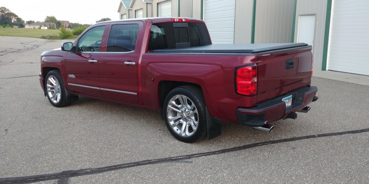

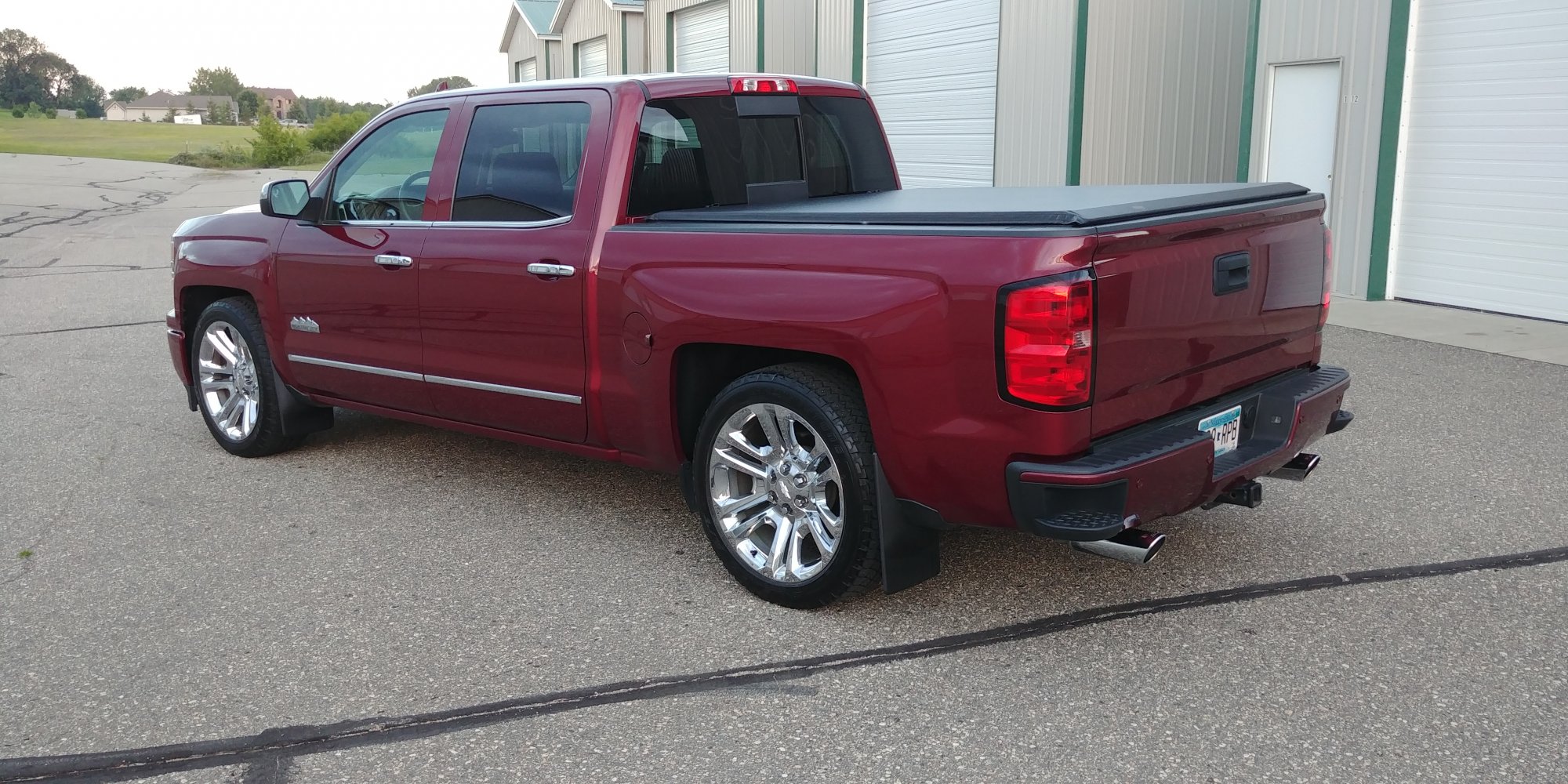

Finally joined the forum. Been following this thread for awhile and just finished up installing a Belltech 3/4 on my 4wd truck. (struts, spindles, and a flip kit)

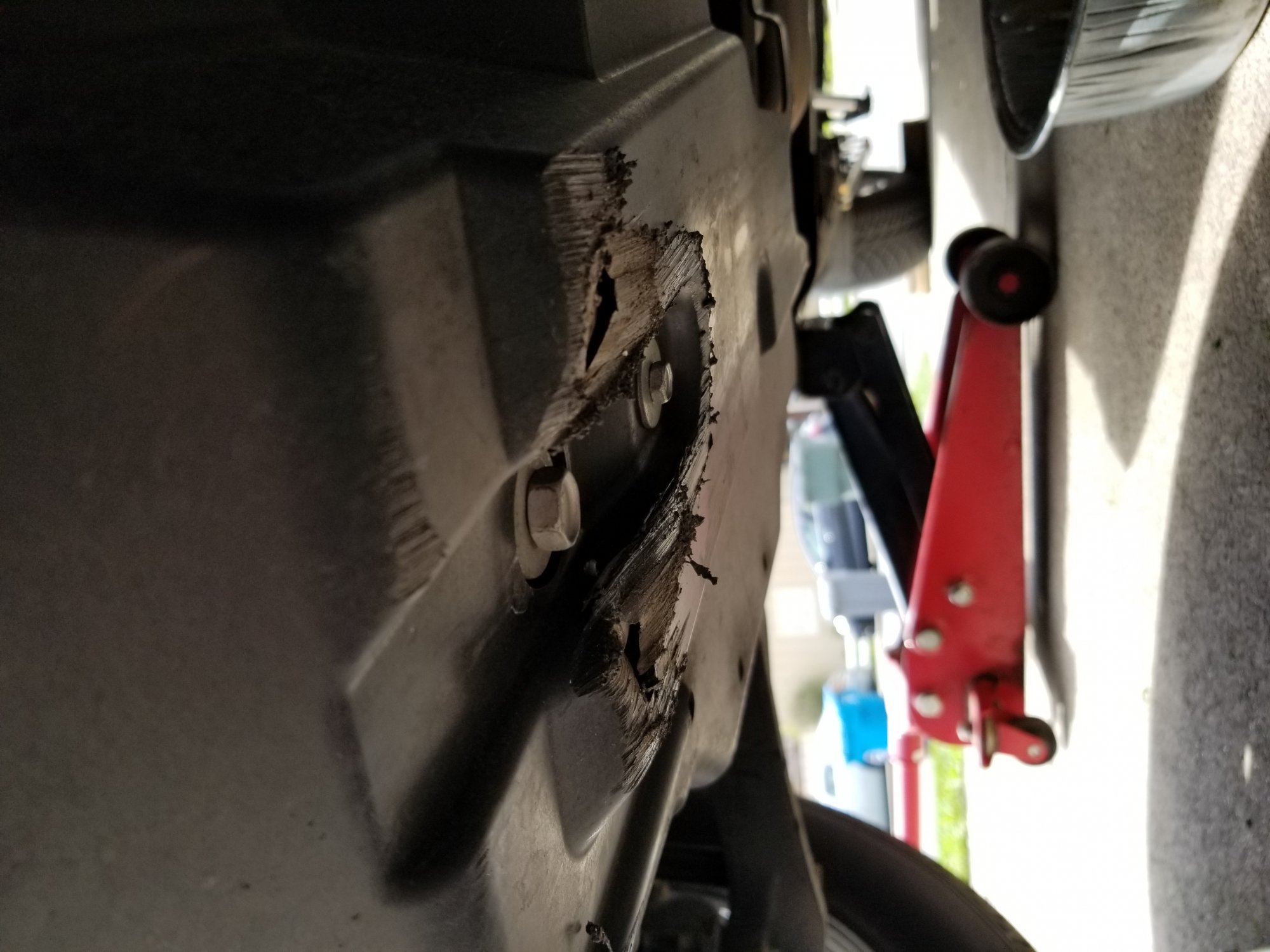

Did some measuring since I got up early thinking about this thing.  Right now the front measures 32.5" from ground to wheel well.  Originally my front measured 36" to fender.  The rear measures 32" on the driver side rear and 31.75" on the passenger side (which explains why the bottoming out sounded like it was from that side).
Right now the truck bottoms out quite easily.  Heck if I just stand on the bumper and bounce I can easily bottom it out.  With the reverse hanger I had planned on coming up a couple of inches (a 5"drop) which I assume would greatly reduce bottoming out.  However that re-introduces the rake, based on the above measurements, that I really do not want.  Obviously I can just raise it 1" (a 6" drop) and the rake would effectively disappear but I am concerned that I would bottom out on a regular basis.
My goal with the lowering had always been to give it more if a street truck look and improve the ride quality.  At this point I am leaning towards changing out the front and find something else that will give me a 2 to 2.5" drop in the front with as few other issues as possible.  With that I would raise the back to a 4 to 4.5" drop which I would expect to eliminate bottoming out altogether.
I am actively interested in input and suggestions.
A 2/4 would be perfect for that kind of stance. A 6" drop should really be put in with a notch. The top of the axle is only a couple inches away from the bed. If you look on top of your rear axle there is a bracket that sticks up off of it. That's hitting the bottom of the bed. The corrected shackle and removing your spare tire will help. The drivers side is a touch lower due to the added weight of the gas tank. It's measuring lower now because the parts are settling back into place.
As for alignment, my shop didn't have any issues getting alignment but said I don't have very much play left when I go lower. That won't be until my air bags go in though which will also be new arms and a 4 link rear.
