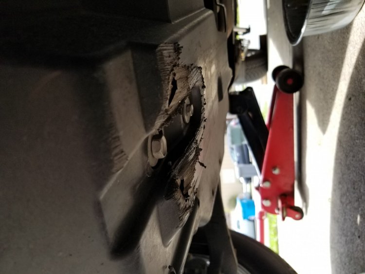

I have a regular cab. i bottomed out but i have bump stops now
How'd you end up doing your bump stops? I have some puck style stops I was going to bolt into the the frame rail but I think there may be a better way.
Belltech stops.  Cut thread off. Used a#10 self tapping screw to the frame. that way if it wears out. I cant unscrew it and add a new one
