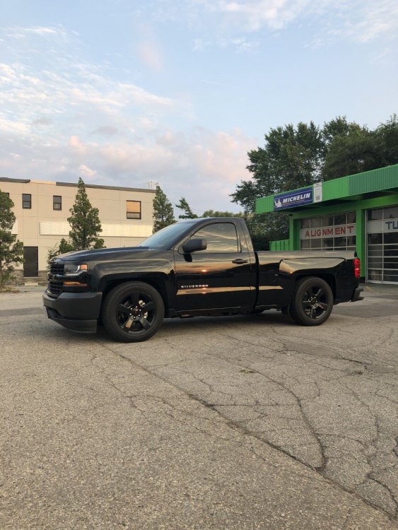

Alright, I'm going to need some help here guys. My gut and measurements tell me that the rear DJM 7" flip kit lowered it too much but I want to know what I should do.
Put it on a flat surface (alignment rack) and here is what I have from fender to wheel centre.
DF - 18" 1/8        PF - 18" 5/8    - 1/2" difference which should be fixed by pulling the 10mm spacer on PF to account for the "Chevy Lean"
DR - 17" 1/2        PR - 17" 3/4
Now another concern is the rear wheels sit way back in the wheel well.
DR is 1" 7/8 - Tire to bottom of wheel well
PR is 2" - Tire to bottom of wheel well
Is this normal?
Any help would be appreciated.
I went with the DJM kit cause I could adjust the pinion angle which was great cause I have ZERO vibrations but this cali lean is driving me nuts
Update...
Installed the 6526 Belltech kit and got some better results
DF 18           PF 18.5             *Haven't pulled the PF spacer yet*
DR 18.25      RR 18.5
The rear wheels sit a little more centre in the wheel well but not by much
DR is 2" from the tire to the rear fender lip
RR is 2.5" from the tire to the rear fender lip
No vibrations. Going to drive it home and back to work tomorrow and re-check all the bolts and maybe see I can shift the driver side ahead at all to make a little less noticeable.
Any suggestions? I've seen a lot K2 trucks around 5-8" drop in the rear with wheels sitting centre and some I see are way pushed back. Going to assume that the ones that are centre have had they're driveshafts shorten?

Yes. Change the flip kit. My mcg kit is centered. and it wont loosen up like the djm tends to do
The DJM is gone, this is a Belltech which is very similar to the Mcg and fixed 98% of my issues. Going back on the hoist tomorrow to double check torque and everything else

4/7 but it ended up measuring out to a 3.75 / 6.5
