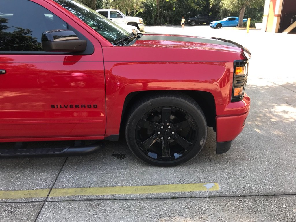

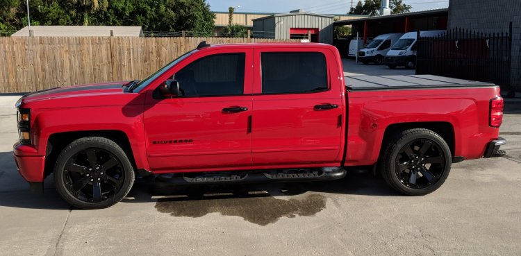

Well I am in a much happier place than a few weeks ago.  Just picked up the truck and it looks just how I hoped it would.  Last time I took it in and they installed the Inez 3/5 kit.  Unfortunately the kit was missing the reverse hanger.  This left the ass end at a 7" drop.  The front end was 3.5" lower.  Both were more than I wanted.  While the truck did look great from the side it was lower than I wanted.  It was drivable but without a C-notch the back bottomed out with any real bump and the front tires rubbed with most turns.  I really preferred to be closer to a 2/4.5 drop so i had a good look with all the regular functioning of stock.  The new stance is pretty damn close to that.
Instead of taking off the Inez lower control arms and putting on a drop spindle my installer recommended putting in half of a lift kit to raise it 1.5" for an overall drop of 2" versus stock in front.  It was much cheaper in terms of hardware and installation at this point.  Ivan at Inez was great at addressing the issue with the missing part by quickly having it send to my installer.  That was installed, and after a little trial and error with the different shackles, got the rear just 0.5" above the front.  The rear drop was about 4.5" versus stock.  The install also included 1.5" spacers to all wheels.  The spacers help to reduce rubbing but, almost as important, give it a wider, cooler look.  Lastly I had 1" bump stocks put on the rear, though with the back end sitting higher bottoming out should not be a problem.  Before today standing on the rear bumper and bouncing I was able to bottom out (please hold any fat jokes - thank you) after a few bounces.  Now I can't get it to bottom out and it certainly feels stiffer.
The front tires are aligned but the wheels still sit further back in the wheel well than I ultimately want.  If I understand correctly this is an alignment related issue.  Has anyone else been able to fix this issue short of removing the lowering kit?

Truck looks good. You don't think the rubbing is caused my the front tire being pushed back so much??

100% the upper arm is angles back   so any downtravel is pushing the tire back and it already looks like its touching
Not trying to talk down on the guy who "fixed" that but for refering lift parts with those arms is a high school move.iwould not take any vehicle there ever again

If you look at the picture I posted after the original install of just the lower control arm my front wheel was farther back than it is now.

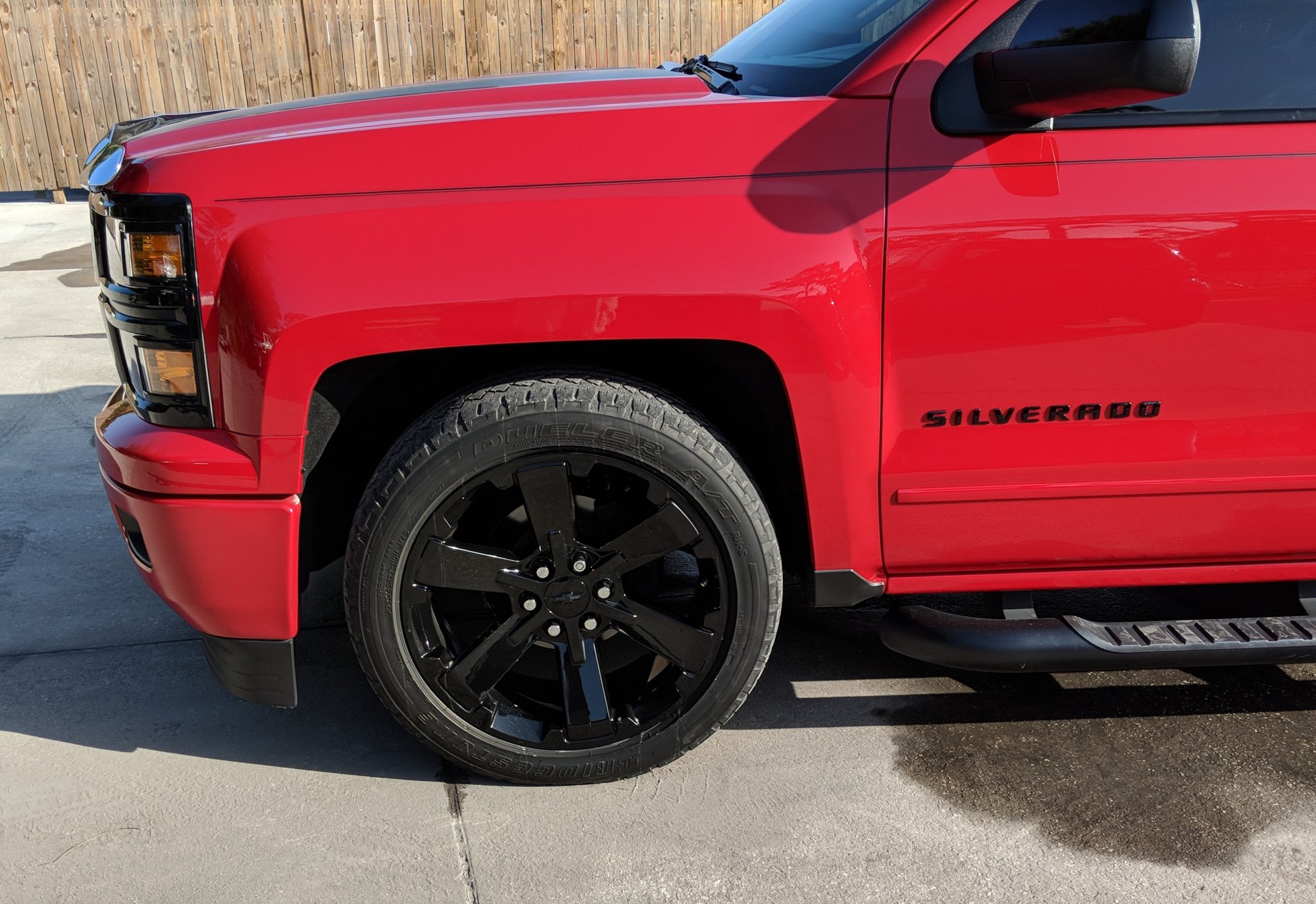

The rubbing is definitely affected by the wheel being back but the picture makes it look worse than it is in person.  It is improved from original which was pretty damn bad (see below) despite what the above picture seems to indicate.
The alignment was done by another company and they had difficulty then getting it aligned.  One of the things they mentioned they apparently had to do to get it aligned that first time was to trim the tie rod to get it to work.  When I asked Inez why it sat so far back versus most other trucks that had their kit they said the wheel placement was an alignment issue.  Tire Kingdom did the alignment and they are a pretty decent company in my other experiences with them, though this was done bat a different shop than I usually deal with.

A closer up shot of the wheel of the current wheel position.
It looks worse now than before to me

My tape measure disagrees with your eyes.

I would get stock arms. the balljoints in those arms are set for a certsin angle. Youve now changed the angle as well
