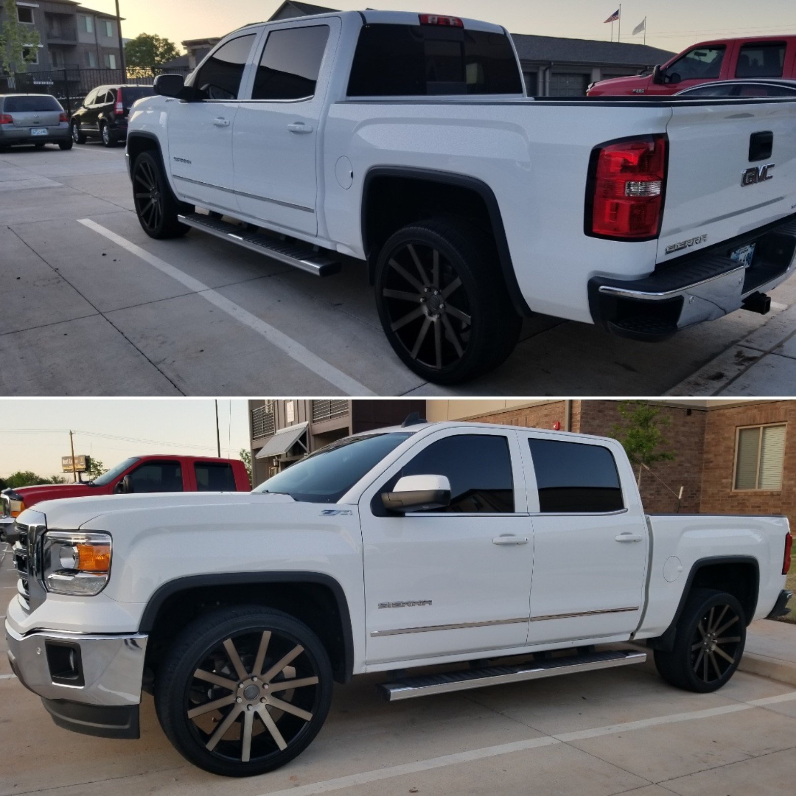

Well got the belltech “2/4” drop on my 2018 reg cab z71. Followed directions on lowering the front which was the struts with spacers and new springs. Used only the bigger single spacer per directions and let’s just say it’s not a 2” inch drop ?‍♂️ more like 3-4”. I cant even pull over a parking spot curb without hitting front valance. Did the rear the same time as well. So I wasn’t aware of how low the front was yet. So flipped the axle on top of the spring. Knocked factory rear hangers off put belltechs hangers on in bottom 4 holes with their shackle which should be a 4” drop. Which I think really was a 4” drop it’s just the front was so low it made the rake look ridiculous. So put factory shackles on it to give it a 5” drop which helped out with the stupid rake. Also I had to cut tailpipe off because leaf springs would be right in the way of its factory exit location. Any else have to do that to the exhaust?

Explain what you did in front please. And give me a .measurement fron center of hub to bottom of fender lip
18” from center of hub to lip of fender on front and 20.5” on rear.

All you have is 1 ring in each strut? And youre using thr spring as well?
Just now, Breedsrt said:
That is correct
Ya you messed up.  1 big ring only is 2" of drop. And the spring ot came with is another 2"
Sheet!!! I guess I shoulda looked at it more. Probably would have seen the springs were shorter than factory one. I was kinda in a hurry. How would you go about bringing it back up? Just add 4 rings on top of the single ring on them now that would make it a “factory ride height” and use the belltech coil? Or take that coil off and put factory on?
How i would do it is put 2 rings in front bringing it up to 3" drop.  And then drop the ass end 1 more inch making it a 3/5 drop but thats just me
