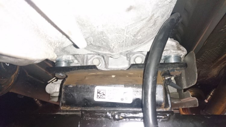

I put the transmission spacers in yesterday. The shaking on take off is gone now. DSC_0995.thumb.JPG.95dfaf039c9717d019cb921a04663812.JPG

Whats thr part number. Maybe i should do it to

6521-774
it's literally longer bolts and 4 spacers.  you could probably stack some washers 3/4'' and get the same results.
