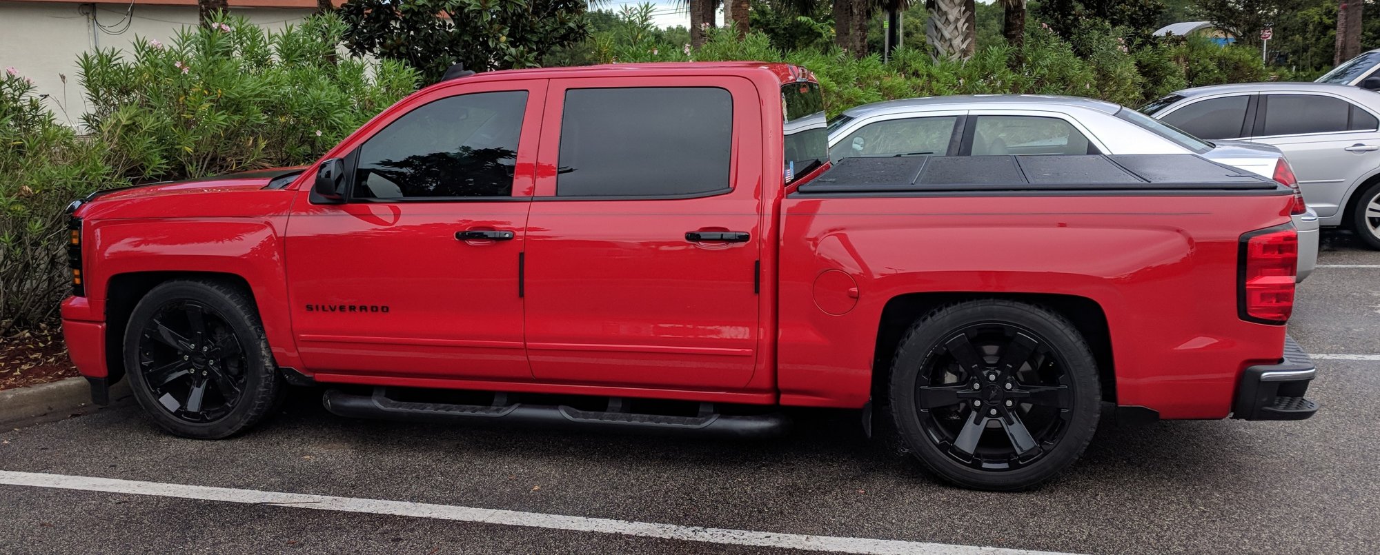

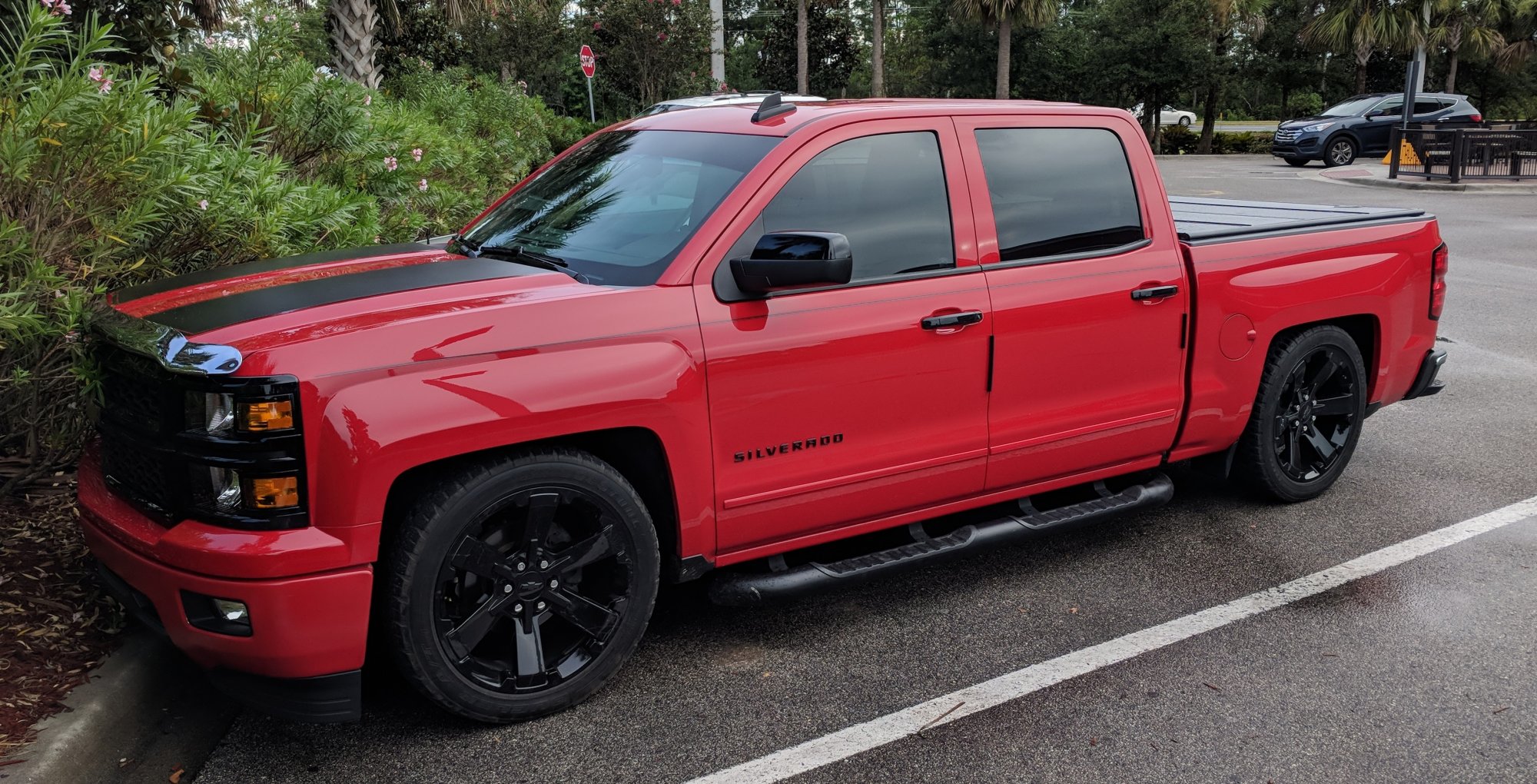

Picked up the truck today.  It is still missing the reverse hanger which will allow the rear drop to be raised but the shop needed me to pick it up because they close on Friday for a week due to vacation.  The part is due to arrive on Friday and if it does in fact arrive early enough on Friday they will install it before closing for vacation.  Hoping for a little good luck.  I also have ordered 1.5" spacers that hopefully will help with the rubbing I am getting or anything more than a moderate turn.
So far I have 3.5" drop on the front and it does appear that the front end is settling lower since the pictures I posted from the shop last week.  The rear is still a 7" drop.  These pictures make the truck look more level than the previous but the rear is still lower than the front.  Not sure if I am happy with so much drop.  My goal was a small drop of 2" in the front which would have mitigated rubbing and not make the drop so pronounced.  I'll see how everything looks after the rear gets done.
Next is getting new tires.  I held off until this step was complete.  Anyone have recommendations for 22" wheels?
PS - in trying to help Nasty out - Nasty does not endorse this kit or any similar that replaces controls arms.  Hopefully this helps saves some wear and tear on his keyboard.
