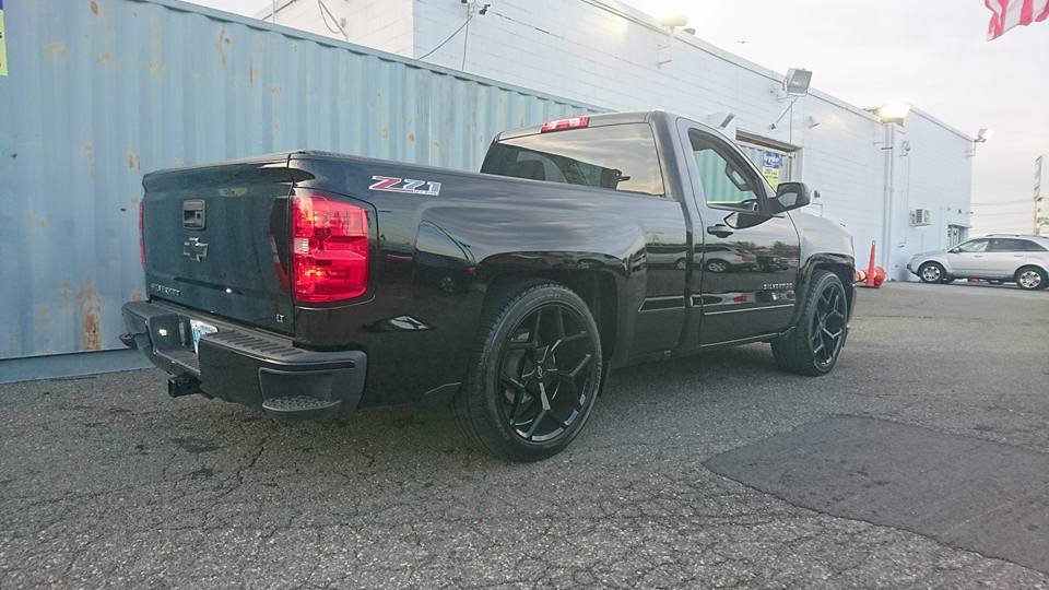

If you're using all Belltech stuff I would leave the shocks at 2'' if you are going to go 6'' in the rear.  I'm only 3/4'' higher in the rear with shocks at 2'' and 2'' spindles in the front.  I even took the last 10mm ring out of the right side to level on the front side to side since my right side was 3/8'' higher than the left. he last 10mm only dropped it down the 3/8 to even it out.  so you might risk being a little lower in the rear if you set the shocks to 1''. Look at my pictures and decide for yourself.

You’re truck is nice!

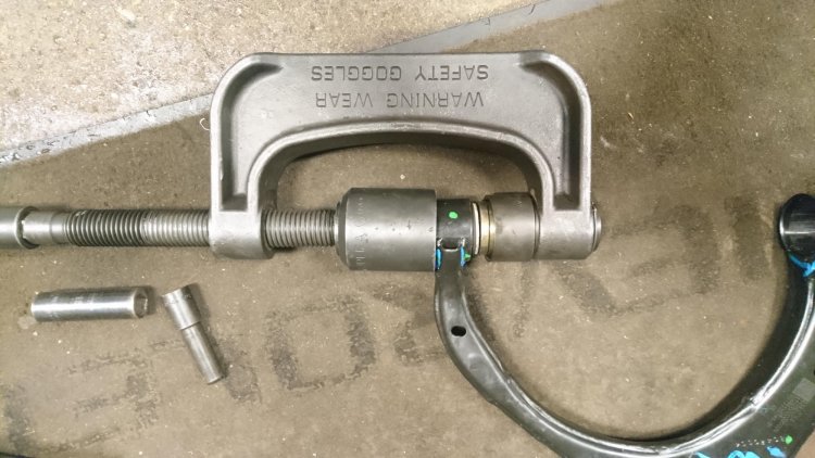

Since you are on a 4/6, it is also required to replace the bushing to get to alignment spec?

Thanks, man!
yes, I did replace the upper control arm bushings to get my camber in spec.  It was a huge pain in the ass to press the old ones out, even with the tools that Belltech supplied.  bushings4.thumb.JPG.ad8f310e3dc11bf1248fae7fa5ef09f3.JPG
I read your previous post during the install, huh,.
Well, I am going for 3/5 for now. Tnxs for the info again.

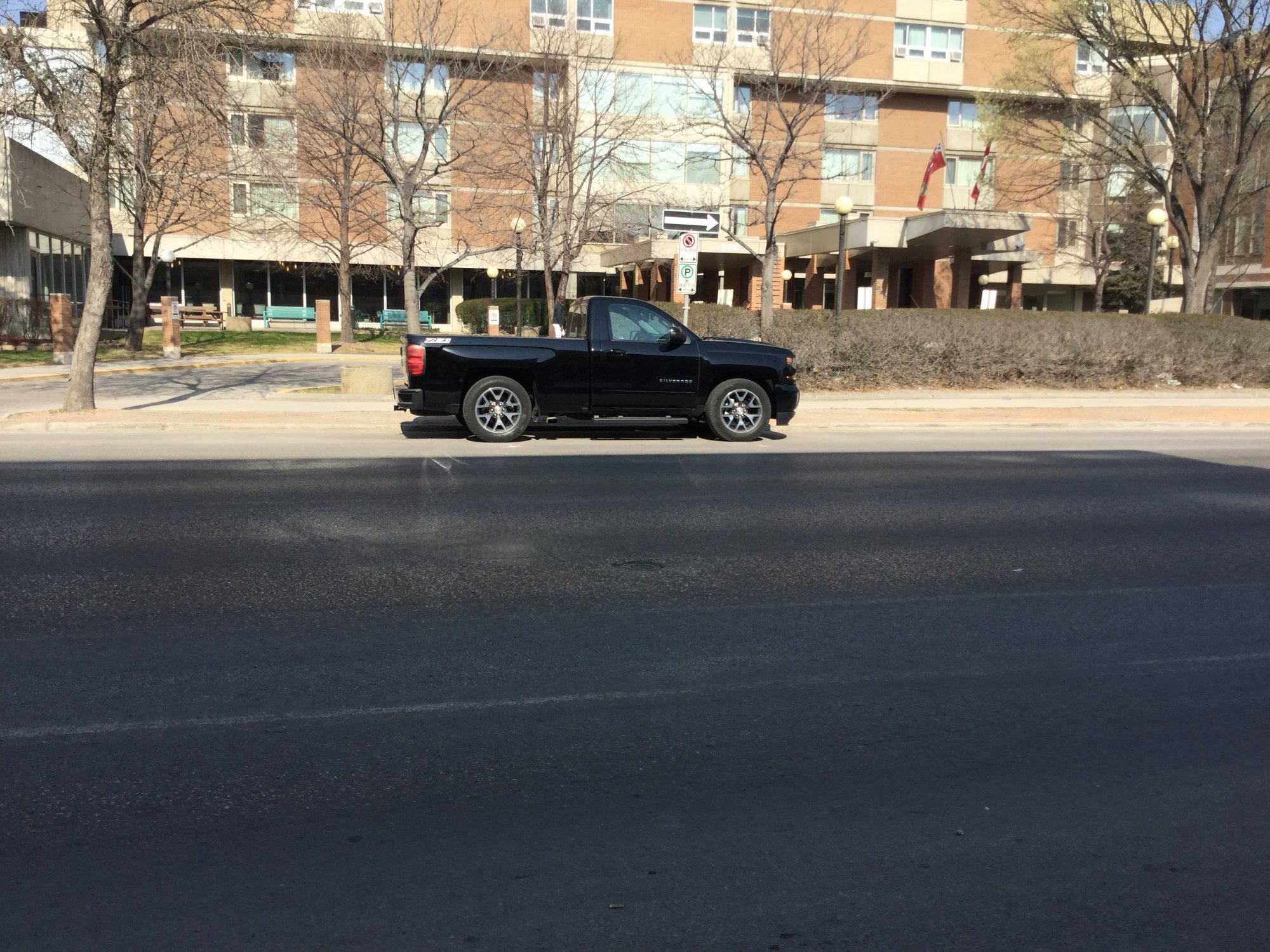

I’ve kept on looking back to this post, your truck reminded me of a YouTube post, see a snapshot I took back in Jan last year...lol.
may I ask the brand as well as the specs of your rim and tire? Tnxs
Prerty sure mmr wheels
Looks like it!
