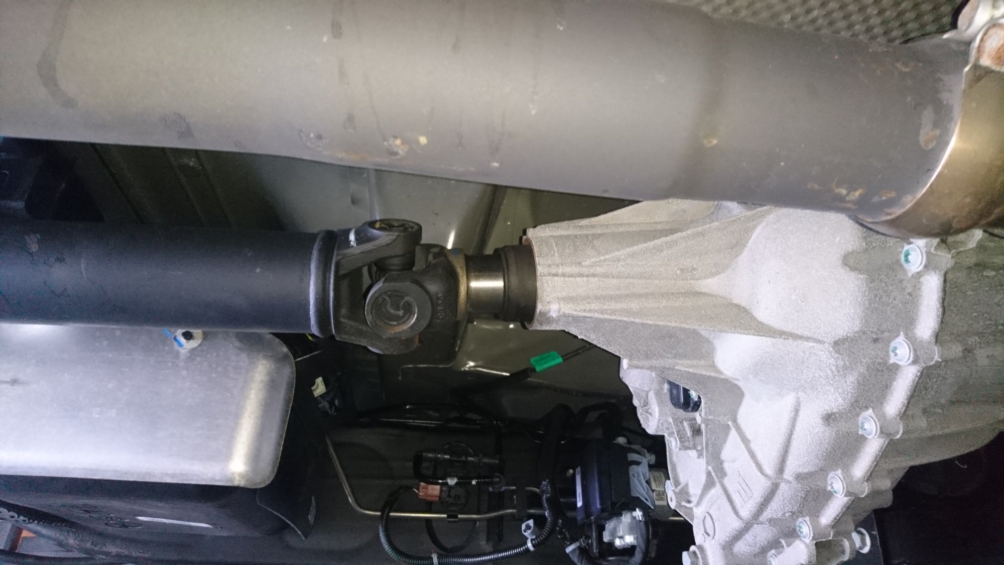

1 hour ago, 204-WPG said:
Currently I am on a 3” drop(2.5” really maybe) with 2”shackle and block removed. I hope everything will sor5 out, we’ll see. The picture will show some 1.5” clearance
You might need to.  And if you want to live dangerously. I have a notch for sale   strongest notch for these trucks
Tnxs, I will keep that in mind. Though I really don’t intend to go for the notch. We’ll see.
I'm around 5" and still have plenty of yoke left. DSC_0835.thumb.JPG.a1a067ce4d2eddafa2486462c45d59da.JPG
The provided Transmission Spacer, it says in the instruction for 2WD only, but did you need to install it?
on the other note, how did you install/tighten the provided bump stop? No access  to reach the nut...Lol
