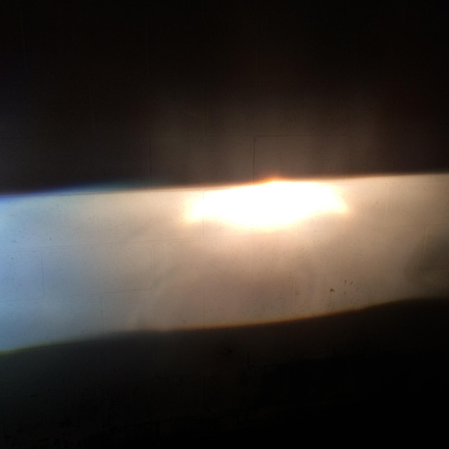

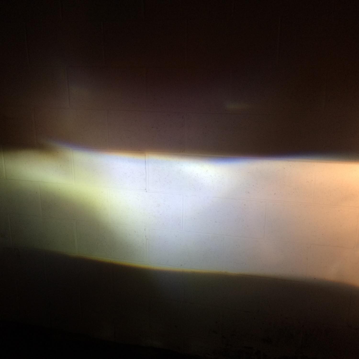

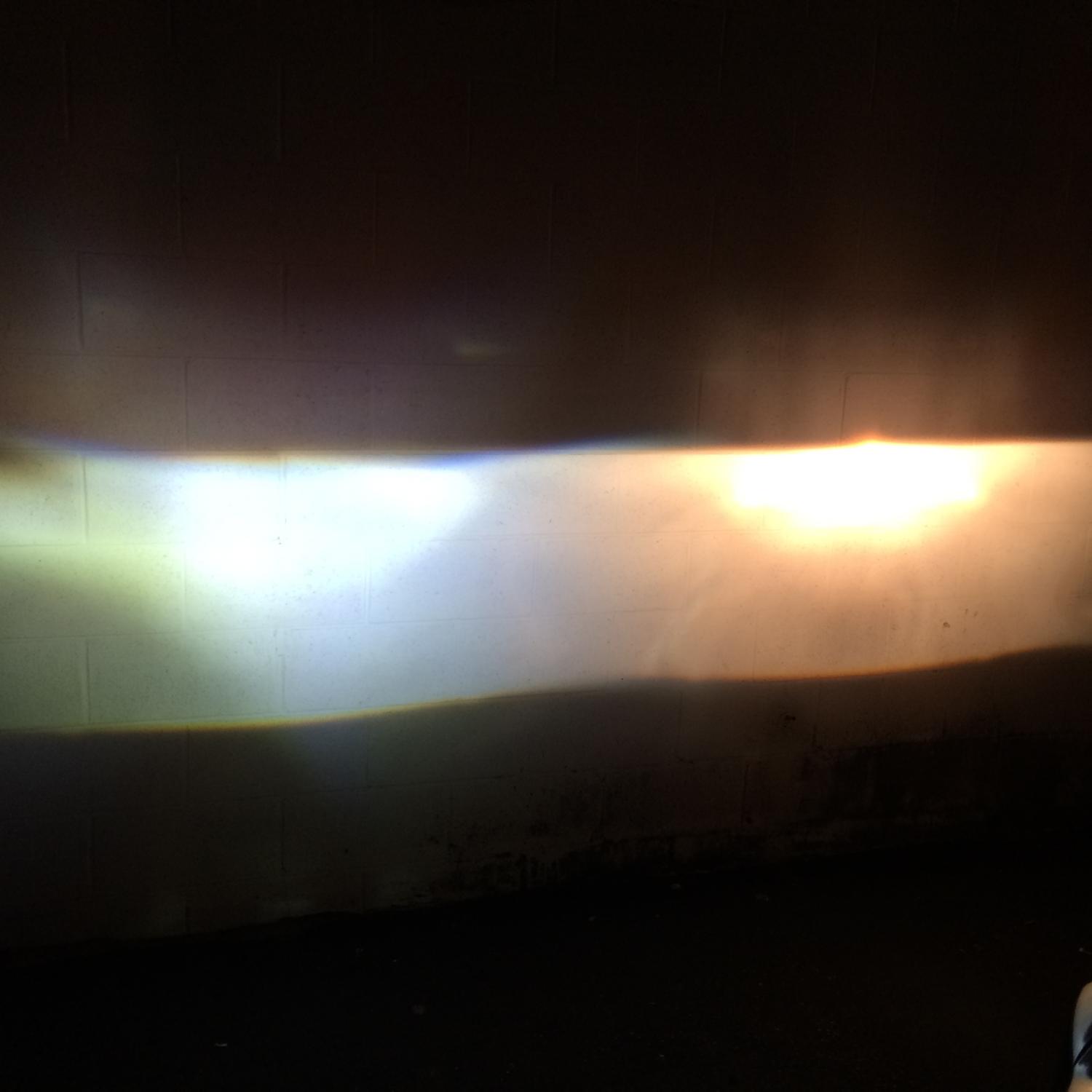

Unfortunately the 9006 3000LM LED bulbs were not what I expected/hoped for and I will be returning them (VLED customer service was excellent). Contrary to the earlier post by Moto, I found the amount of raw light output to be a good bit less than stock at any distance more than 10 feet. Basically the use of the LED bulb and the projector gave a sort of "washed out" effect. Notice how even at about 20' the LED bulb's pattern is creeping down and getting larger, where the Halogen bulb is keeping the shape properly.
I am going to go back to the HID setup for one last chance as I really do not see any other options which address both color as well as light output.
