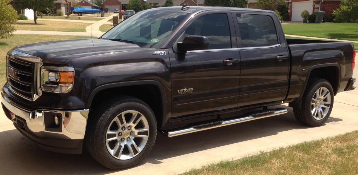

Installed raptor 6inch oval SS body mount nerf bars today so far love them
