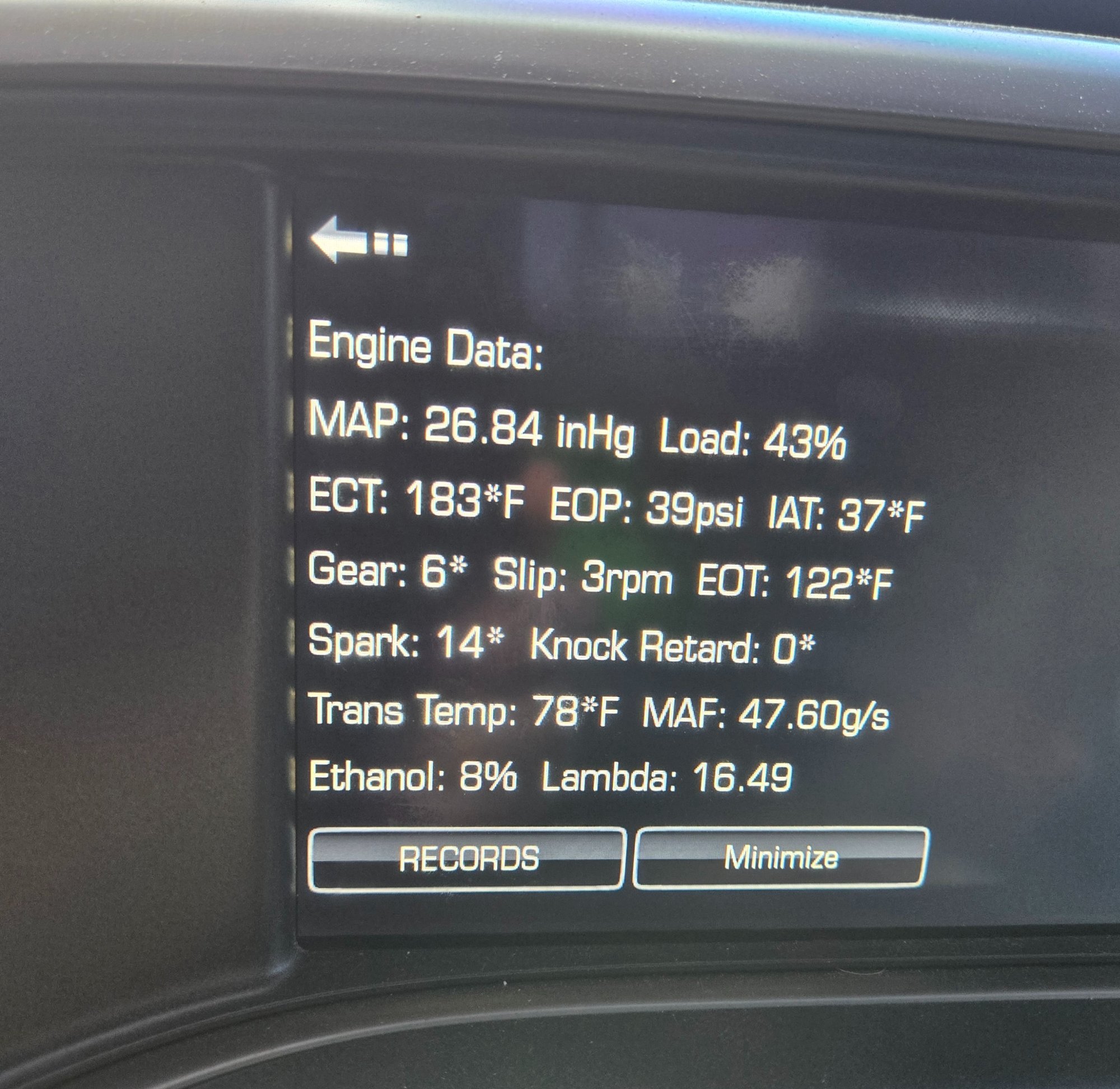

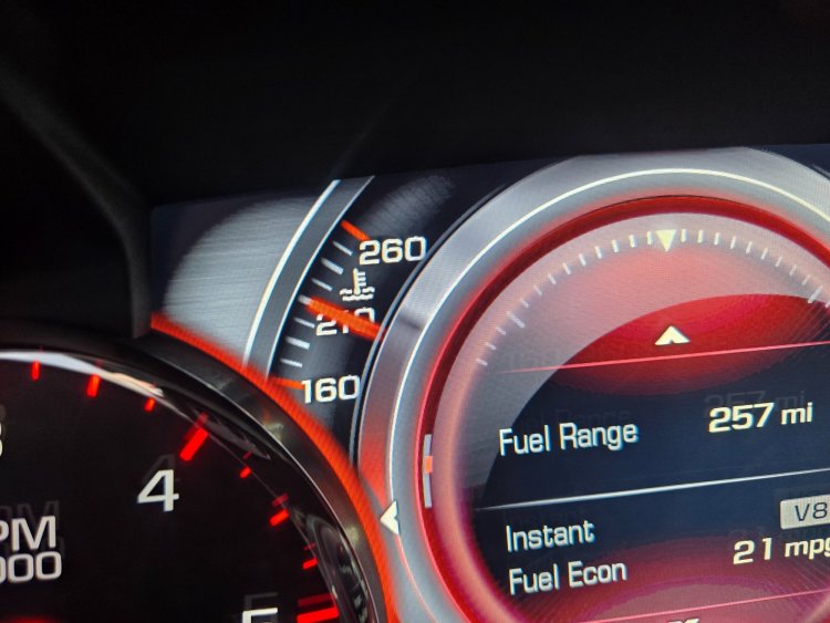

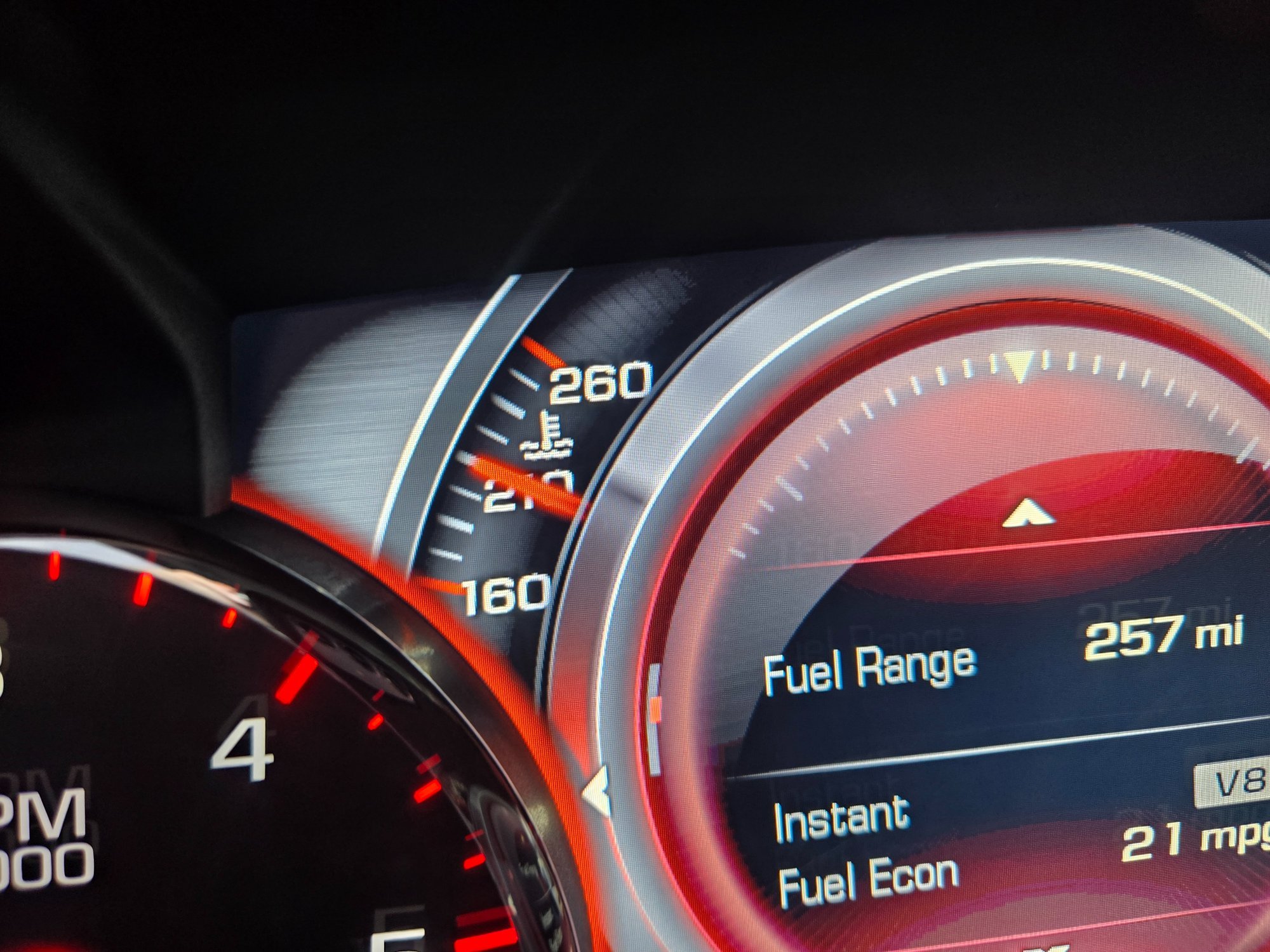

Did you get it recalibrated? don't they always run at 210° on the oem gauge but it's really running at 185° to 190°ish? My 14 and my 18 read 210° on the oem gauge but run at 183° to 187° all day long. On my way to work.20260302_163209.thumb.jpg.f1907fddaa4f785b806300803ba5e1a2.jpg20260302_163157.thumb.jpg.1b21eeaefbbf764ca89c19b2d4c1e274.jpg20260302_163146.thumb.jpg.fa2390a636d891446945d57e4ab9b8d4.jpg

Actually any time the needle is pointed directly at the 210⁰ mark, the temperature could be anywhere from 185⁰ to 220⁰. Once it even slightly moves down off the 210, it is actually falling from 185. If it rises above the 210 mark, it is already going higher than 220⁰. Having the needle steady during a range of temps, I think GM just wanted to lessen concerns about temperature variations.
