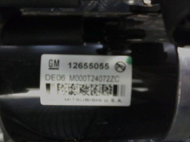

Did you get the bar codes off the ones that failed and the third one that works? I took bar code photo's off my old one and the new one for reference. GM is trying to pin down the time of manufacture of the "freezing" starters. The start part number is the same for 2013's .......so, maybe my Dealer got an older new starter or a newer new starter. GM has provided no guidance on what serial number range are causing the problems ........I did not have a choice, but to put what the Dealer had in stock on and hope for the best - you are right about not getting excited, but this is the first time my truck has started on the first attempt. If it freezes when really cold again, I will get a third starter like you ........... just hoping for the best (that is absolutely a terrible attitude - I want to know that it is FIXED!)

GM told my dealership that any starter made after December should be OK. I didn't get any pictures or codes...I never thought about it! Now I wish I would have.

My Sierra again started at 6 deg. F this morning. This is with the out of dealer stock new starter. I took pictures of the old non properly functioning starter and the working replacement starter .....: Photo 3 is the old one and photo 4 is the current installed and working one.

this is the starter i took off my 2014 silverado, gm tech had me order a differend starter i will plst a picture of the new style.
Mexico starter bad... USA made starter good. Who would have know? The US worker that's WHO! :thumbs:
