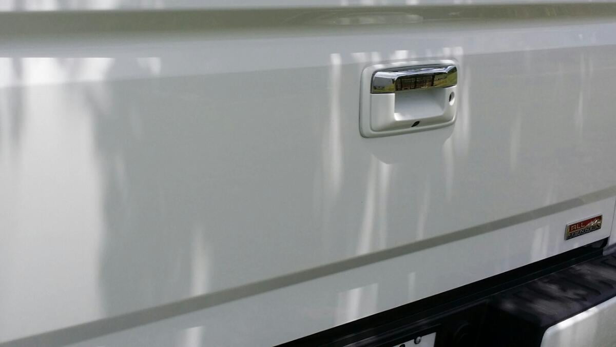

Here's a picture of the tailgate handle I ordered, with the chrome and painted the rest to match. I also debadged the tailgate only left all terrain on right. Painted front gmc emblem, fender flares and fog light surround. Next is the mirrors.
