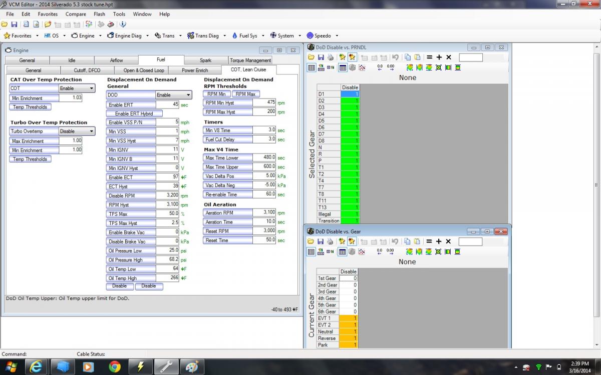

Well.. there is a lot more to it than that so instead of me typing it all... here you go.
If there is anything in particular that you have questions about, let me know and I will try to help explain it.

Ok... once you look at that picture real good.... that is everything it takes just to activate DOD. Just imagine what it takes to move that new 2014 truck down the road.
My truck only goes into V4 in sixth gear. In town I keep my truck in m5 so it never goes into V4. I'm going by sound and dash .
This is correct... If you look at the Pic I attached you will see a green column labeled DOD Disable Vs. PRNDL. Everything is disabled except Drive (drive is not an option)
Gears when in drive can actually be selected in the table just below that one.

LOL... I was just like you until I spent a hand full of times hanging out with Ed Wright. After witnessing the VooDoo he could do with LT1/LT4's I was instantly sold on Fuel Injection and Custom Tuning. I will admit that my background in Electrical Engineering/ Automation and Controls didn't hurt though.
Your dilemma with in town DOD can be tuned out though, I have mine set to come on after 55 mph.
